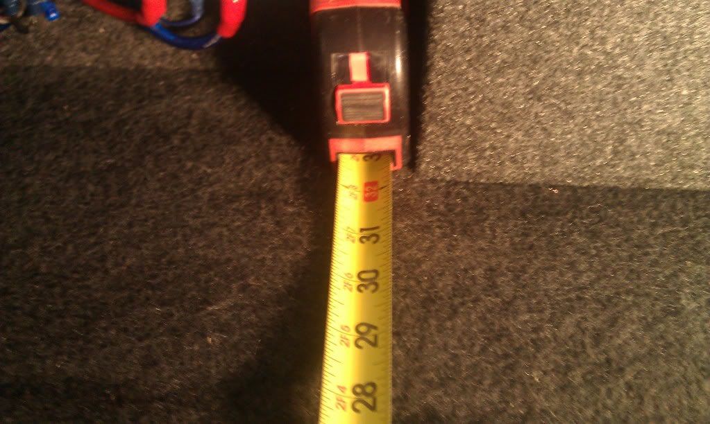

          The box is quite small:
          Installed, it seems smaller still:
          and I swear to fuck, we will get some amp racks built...we even have the pieces cut already! The look is tidy, and if you feel some silly need to shave a whole 20 pounds off your cars weight for track use, you could engineer some easy way to remove it and leave the amp in place, so you don't trash it by removing the RCAs repeatedly.
          Installed, it looks mighty tidy:
