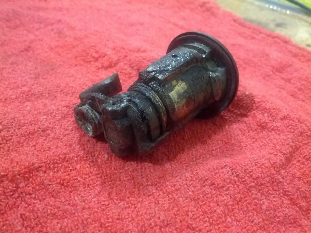

                          Pulled my lock tonight and found this:
                          Ordering 2 lock kits tomorrow and a driver's side actuator as well.

                            My lock looked just as nasty. If you turn the key you should see the double lock leg "bounce" a bit which will tell you the ball has done its damage. Either way, its out and a good thing to replace.
                            Here are a couple of links that really helped me.
                            Find information, resources and relevant links for e30world.com. This domain may be for sale.
                            I would also encourage you to install the new lock before you replace the actuator and do not..I repeat DO NOT...ever re-solder that thermal fuse with new solder. I won a dumb-ass award by frying all my actuators doing that :-)

                              That's pretty much exactly what the lock did. Thanks for the info.
                              Also, thanks for the tip about the actuator. +1 internets for you.
