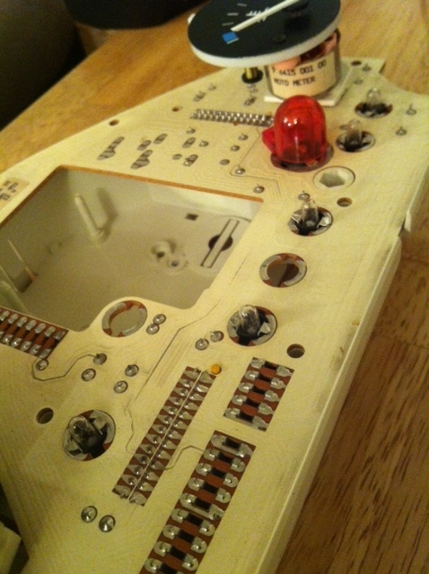

          Check this out:
          See how some of the traces on the board are black? You can follow it from the SI board connection, up to the tach/MPG gauge, and also over towards the temp gauge. They are slightly burnt I think. The black wipes right off, but it surely isn't supposed to be there.
          I pulled a spare cluster, and put my front cover with the SI board on the spare cluster, and it did the same thing after about 20 seconds, turned those same traces black. So I took a spare known-good SI board, and put it in my front cover, and put it on my cluster, and everything is working great. The MPG gauge is working 100%.

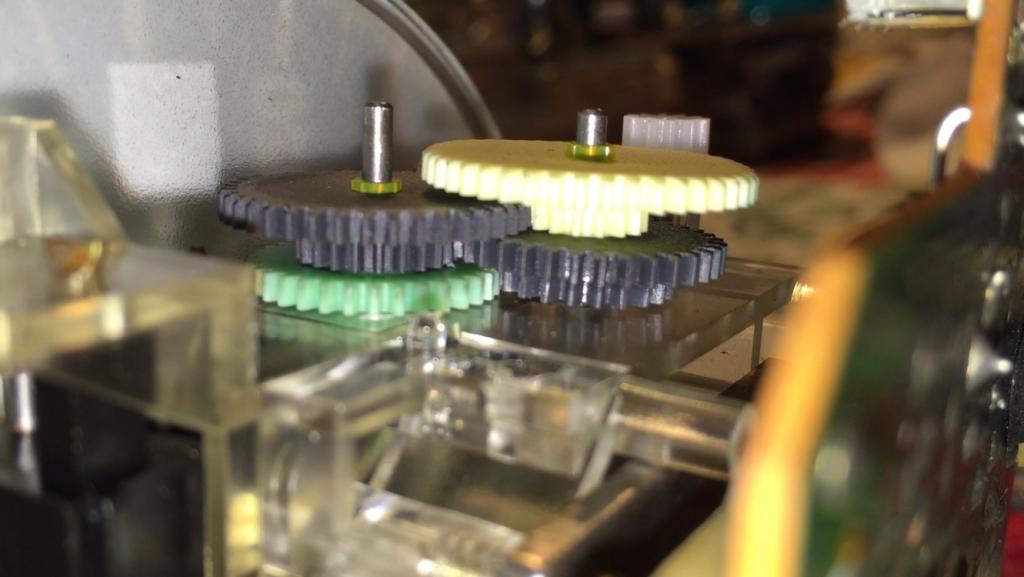

                          I just spent about 6 hours today trying to figure out basically the same exact problem you where having OP. Thanks so much for posting this. I ordered some gears to repair the odo on my new convertible.. My gear was cut improperly, I spent the whole day swapping out mother boards, rebuilding another speedo I had laying around, all to find out my installation wasn't the problem, nor was the car. It was the damn gears.
                          I hope this picture will help someone at some point, this thread with no pics helped me 3 years later! As you can see, the bottom right gear would install just fine, but after driving a couple blocks it would become crooked like in the picture bellow. Here's a picture right after removing it from the car for the ~7th time today.
