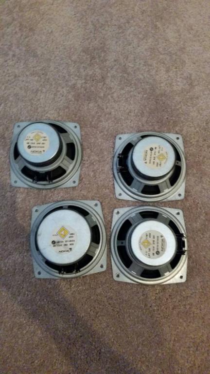

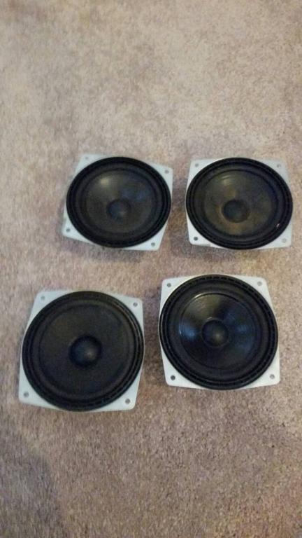

          Found these today Luke and they look brand new! But the drivers side front midwoofer was slightly bigger than every thing else. It is also a 4 ohm and 6 ohm compared to the other 4 ohm speakers. Check pick but this was out of a 95 525i also a 93 with the same speaker but in worse condition. Looking forward to the crossovers getting here. Click image for larger version
ID:	7167878Click image for larger version

            Hi Luke,
            Have you tested the Non-Handsfree version of the E34 speakers [P#65138370936]. There are plenty of these on online compared to the other P#....35.
            They look very similar to each other but the 35's have a green sticker and 36 have a blue one.

                      Originally posted by Rmlr
                      Hi Luke,
                      Yes, I have. I cannot hear a difference and the impedance measurements seem almost exactly the same. I think that functionally, they are the exact same thing.
