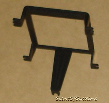

  • e28
    replied
    Originally posted by twothrees
    The analog clock bracket is part # 62-13-1-380-009. I got it from the dealer for $4.14, tax included.
    Does anybody have the bracket and wants to sell it (62 13 1 380 009)? I WTB it. Does your dealer still have it?
