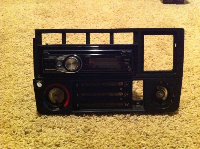

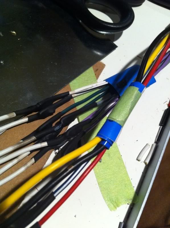

        I hate aftermarket head units because they don't ever look 100% stock. Since my aftermarket head unit circa 1994 (seriously including 10 disk in the trunk) finally took a crap, I decided it was time to use a few Bestbuy gift cards I had lying around.

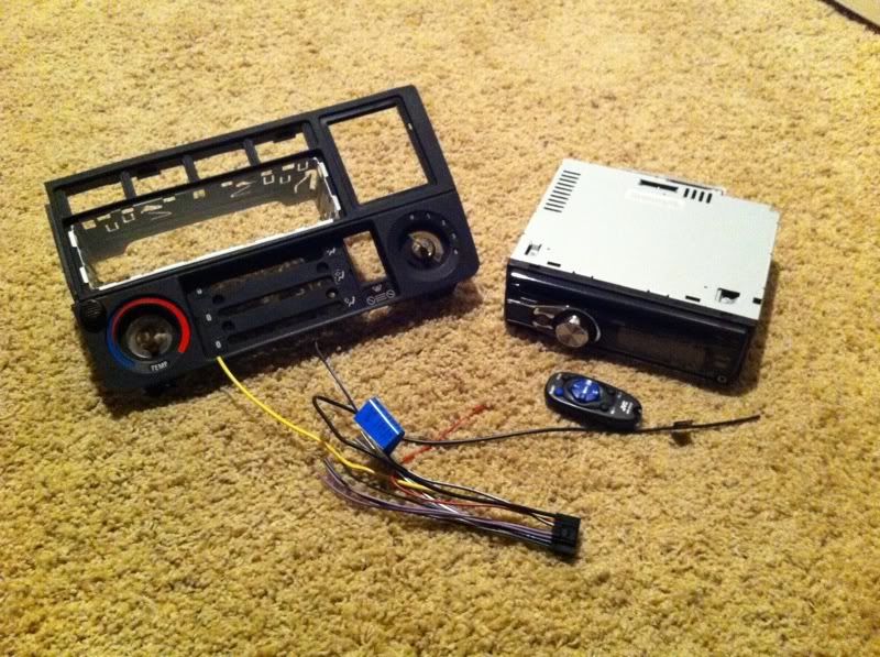

        So I bought this:
        $100 JVC KD-R310
        And started. I test fitted it in the Hvac just in case my idea didn't work.
        Then went about seeing how far the harness would reach.

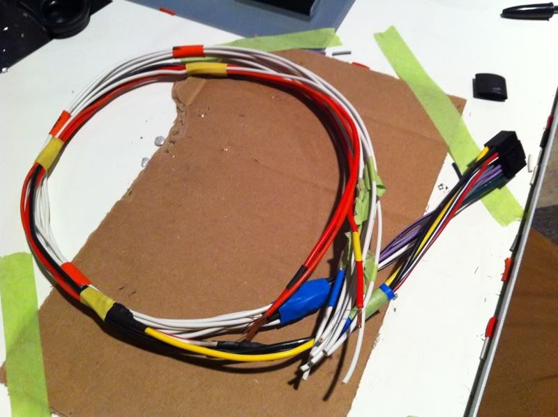

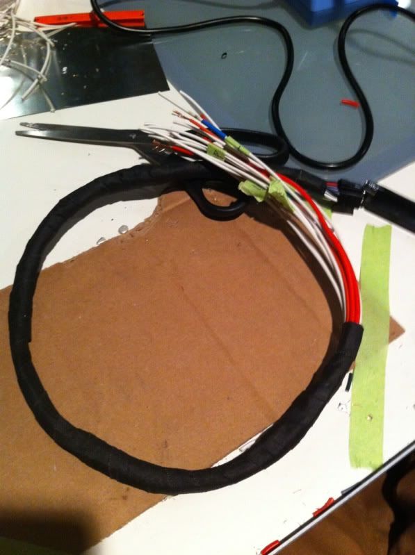

        So begun the tedious process:

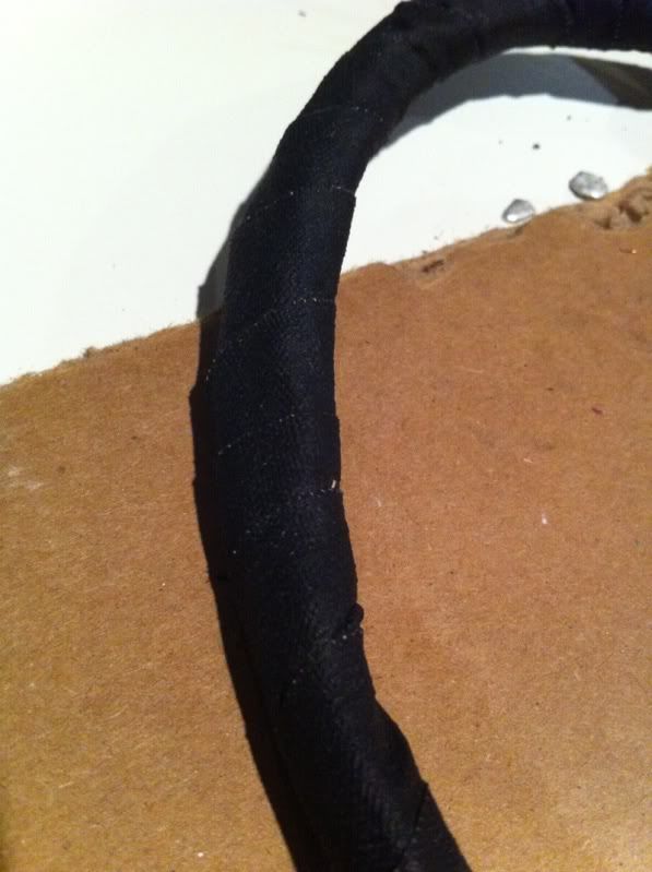

        Wrapped it all up with cloth friction tape:

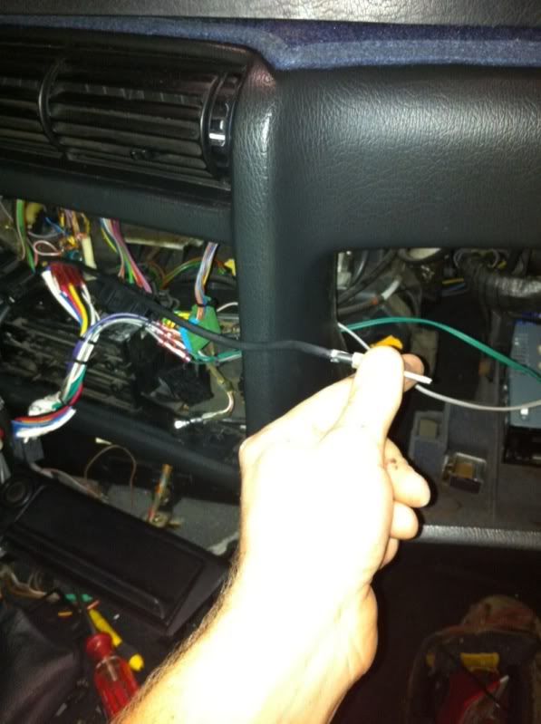

        Branched off 3 wires for the stock radio. Constant, switched, and ground.
        Tested everything:
        Soldered it up because quick connects like to quick disconnect! :p

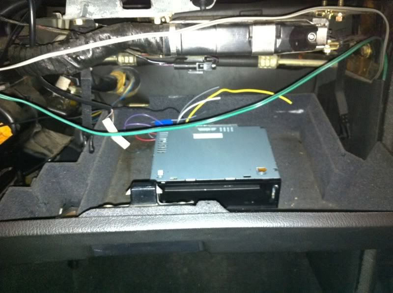

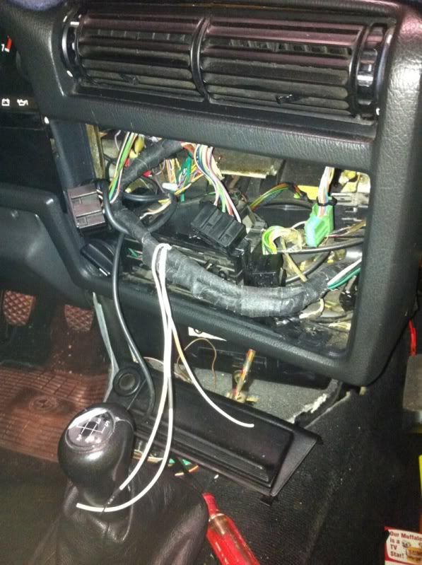

        Then wrapped it all up and put it in the factory ties in the back of the dash.

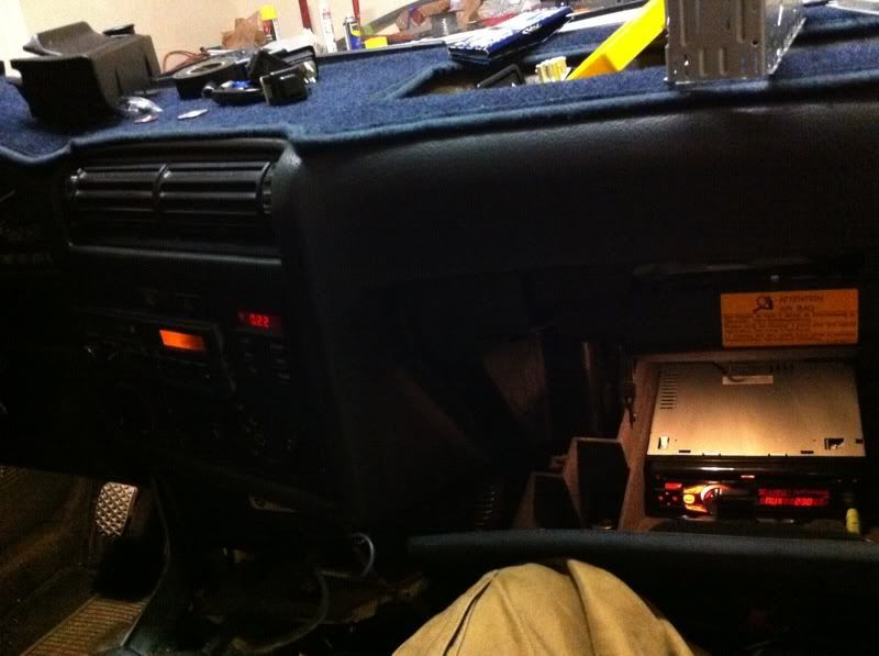

        Finished product: (Pics are craptastic)
        Draw backs:
        -Well it is in the glove box, so I had to get an extension for the antenna.
        -I didn't think about it till after I installed it, but you need the remote to operate it. IR doesn't work through plastic and foam. My old radio had a remote receiver plug for such an install, so I kinda assumed they all did. I mean come on a 1994 model radio had it, why not a brand spanking new one? It's okay, I listen to satellite radio and my ipod most of the time anyway and don't change the channel, so it works, for me. :o

            Glucklich21, get an infrared repeater. It will have a receiver an "eye" about 1/2 " diameter. Mount this in the blank plate beside your hazard switch. You can route the signal wire behind dash and mount onto the unit in glovebox. then your remote will work.
            chucker
            89 M3 "Ms. Bavaria" Garage Queen Cinnabar w/ black guts
            12 Chevy Avalanche "OJ" Black on Black and.... Loaded
              #51
              I saw one of those, but wasn't exactly sure how it worked. I figured it needed power somewhere.
              And thanks for clearing that up. ;)
              I was planning on putting something in the temp sensor vent thing on the hvac panel.
