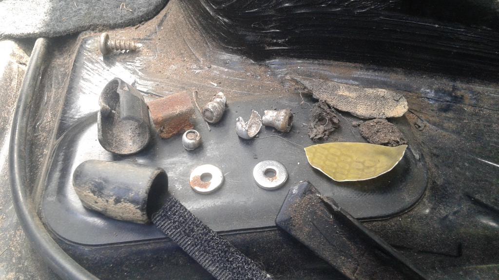

                      #55
                      great write up..
                      Doesn't look that complicated, it's to do it in the right order and to make sure the glue is in the right place..
                      I would attempt this when the time comes as i found out this is the second top on my car.Some goodies i found while cleaning 30 year old dirt under the cover.
                      This would probably take me a week....
