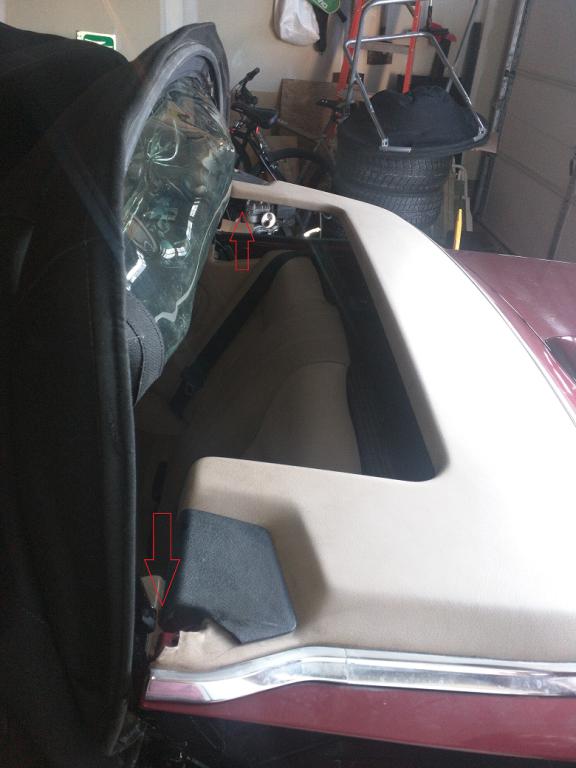

                      Just bought a '92 and when I'm opening the auto top the tonneau cover gets stuck on the rear part of the top when it's closing again. It looks like the rear part of the top doesn't go up far enough for the tonneau to clear it. Does replacing these shocks potentially help this?

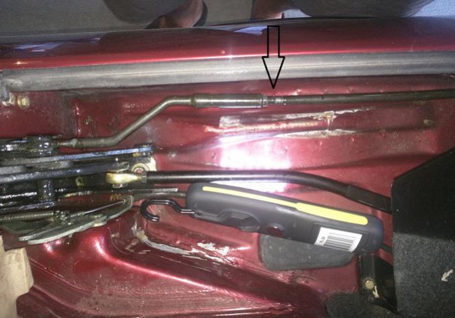

                        amre - no. The rod that flips up the back of the top needs to be adjusted. It's one of the two that are connected to the motor in the right corner of the top well.

                          I tried adjusting it with no luck. I tried both extremes to move the nut to either end.
                          I'll try and post a picture later.

                            Here are the pics. The black arrow shows the nut I tried to adjust. I tried adjusting it all the way both ways with no change. The toneau cover still doesn't clear the rear of the top. It's only off by a bit but enough to rub and scratch the top as it closes. I just ordered the two shocks in case that's it.

                              Did you just move the nut back and forth, or did you disconnect the rod from the motor and rotate the rod? Moving the nut back and forth does nothing. It's just there to keep the 2 pieces of the rod from rotating accidentally. Rotating the back half of the rod changes the length.
