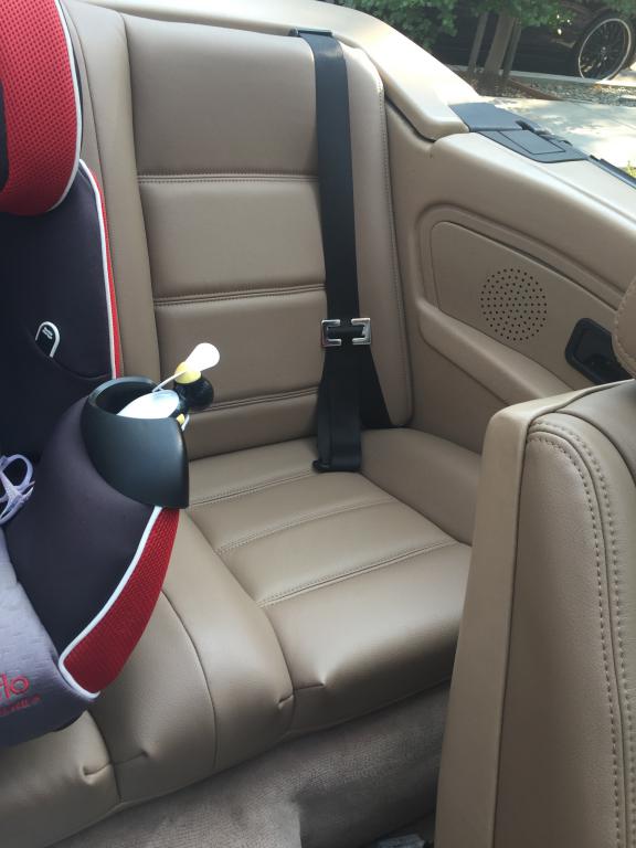

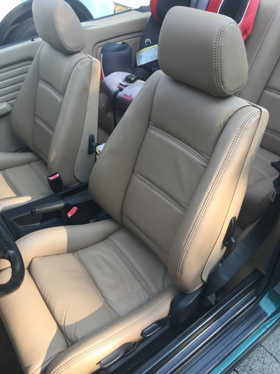

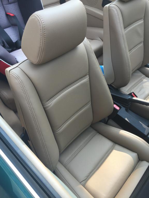

                      • berndt
                        • Mar 2016
                        • 104
                        I'll get some pics after work today.
                        • berndt
                          • Mar 2016
                          • 104
                          They aren't perfect, but I'm happy with the result. Other half of back seat has a kid seat :).

                              Pretty nice - very decent fit. Thanks for posting!
