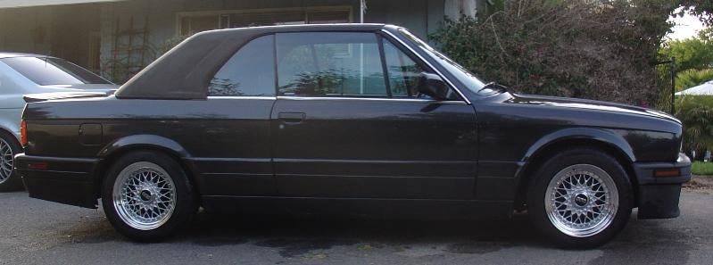

          H&R sport springs and Bilstein shocks. 8X15 wheels with 205/55 tires.
Name:	RS complete 1.jpg
          Cheers,
          Jim
                [ATTACH]42679[/ATTACH]
                Cheers,
                Jim
                are you on billy touring or sports with this setup?
                • IronmanE30
                  • Sep 2009
                  • 2121
                  #398
                  Sorry, I should have said that I used the Billy Sports. Touring=stock springs sports=lowering springs:)
                  Cheers,
                  Jim
