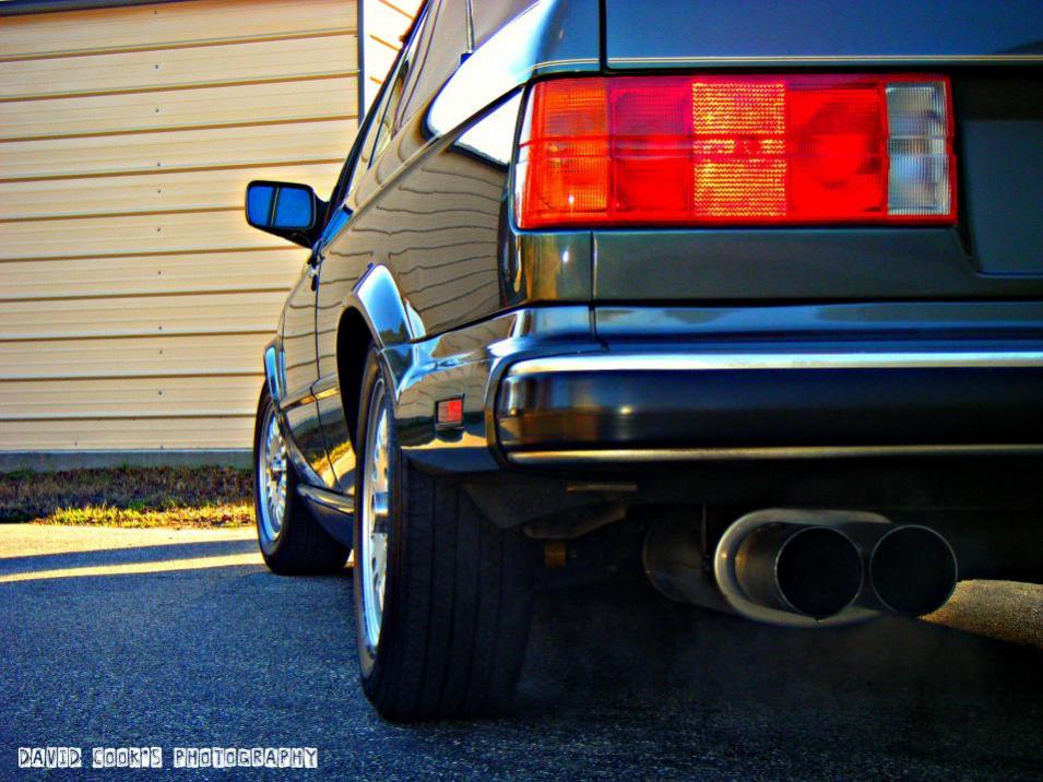

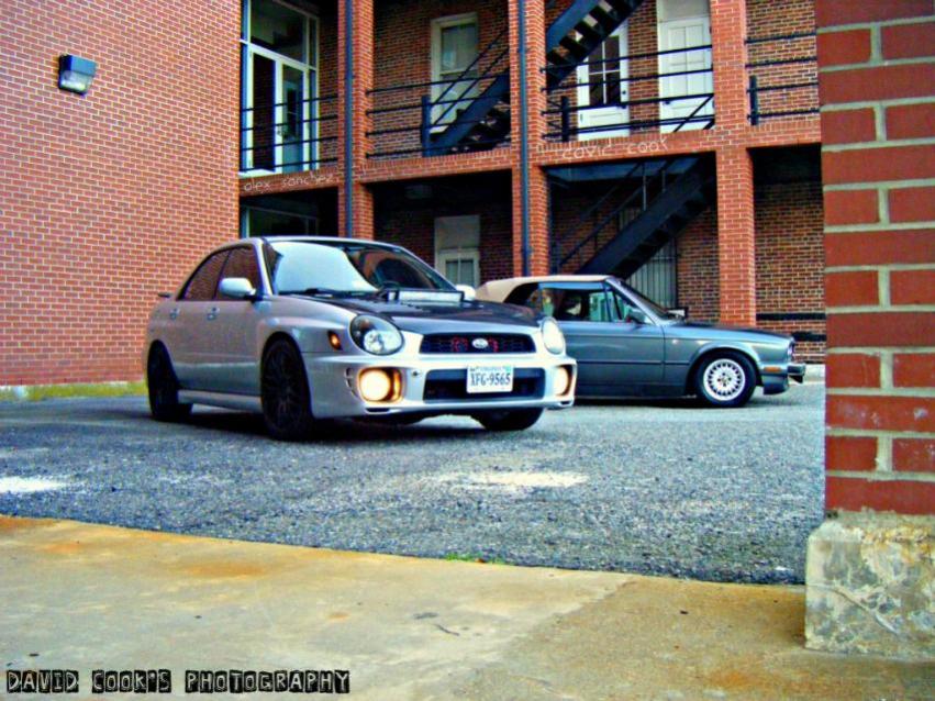

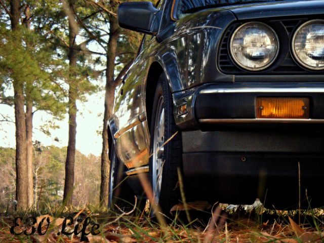

            This is my 1987 325i Convertible
            H&R Sport Coupe springs on Bilstein HD's (revalved)
            New centered bushings, Control Arms, Sway bar links, re-enforced strut mounts and shock mounts, and new tie rods.

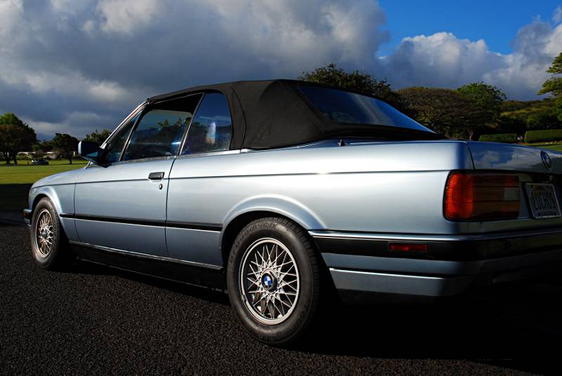

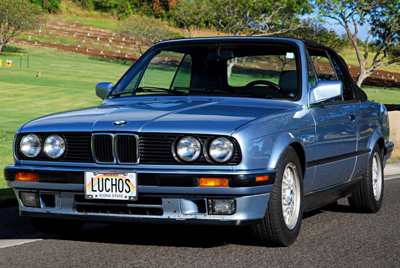

                      This is my current setup:
                      Front:
                      Billie Sports
                      Eibach Pro-Kit for Sedan/Coupe
                      All pads in
                      Rear: Bone stock
                      Running stock size tires

                                Originally posted by 5ickride View Post
                                Just got her back a few days ago and im sure she'll settle in a bit more.
                                Bilstein Sports
                                HR vert springs
                                15mm drop hats
                                Spring pads still in
                                do you happen to have any negative camber on your rear?
