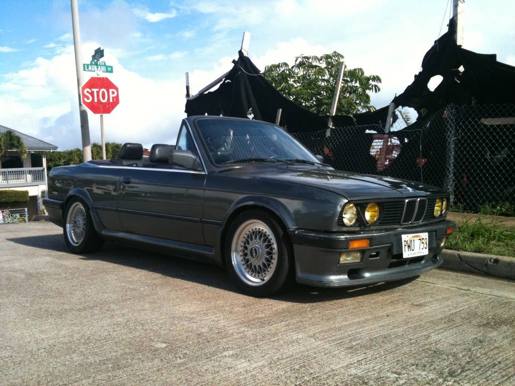

                    Eibach 'vert springs, billy sports, one rear spring pad removed, both front pads removed, e90 drop hats.
                      Here is my car lowered on eibach cabby sports, billy sports, top spring pad removed on rear, both spring pads removed on front, e90 drop hats.

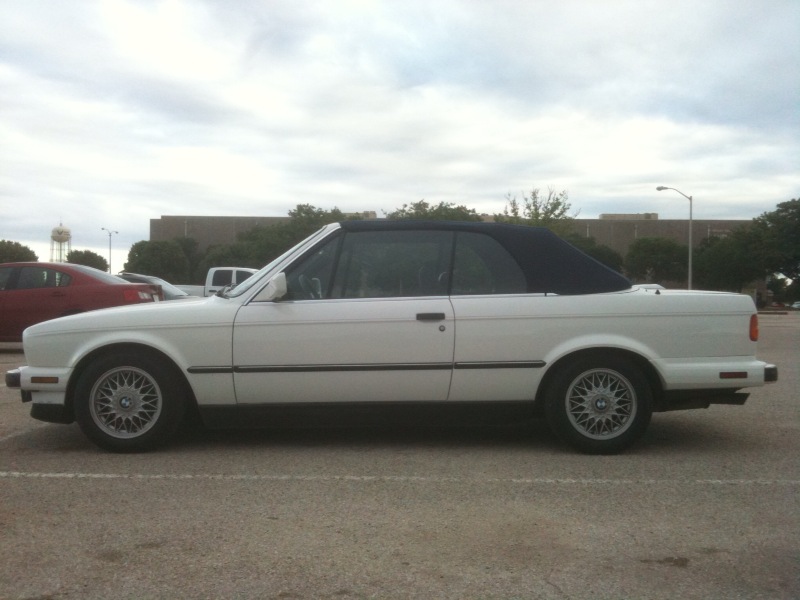

                        I find that the H&Rs to be a bit softer...which is odd because I usually read that they were the firmer than the 2.

                        No drop hats...even though I have some 15mm drop hats waiting to go on. Just last week I put some H&R coupe sports with pads in the rear and its a near perfect stance. No pix yet.
                        MT2 are just another flavor of an e30. Banning you is not nessesary. I personally like them alot and its hard for me to even think that this one is going to be for sale soon. Its just something about the Glacier that has me hooked!
                        You do have a nice stance but I would think that your overall ride would be lower. Maybe its your 14"ers. It may need to settle if its a new suspension.
