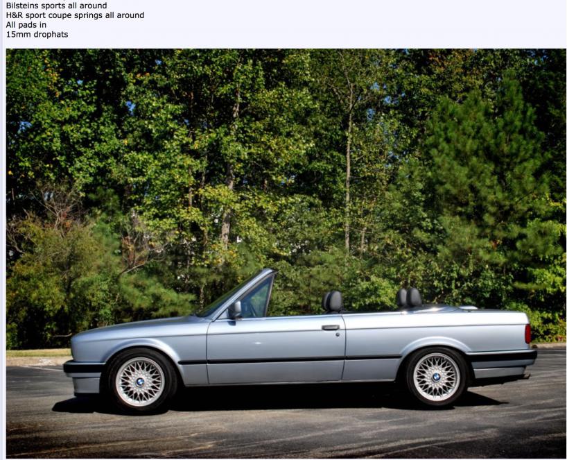

    Basically, I saw a car on this thread (photo below) and decided to copy the set up. Billy Sports, H&R Sport Coupe Springs, all pads in, and e90 Drop Hats. About 3 weeks to a month since installing these parts, it seems like they're not going to settle anymore.

            Well, since you referenced my car, ill chime in. Something is odd up front, and im not sure what. Although you are using different drophats, it shouldn't make that much of a difference. Mine are 15mm while yours are ~9mm. Brand new bearings could raise the car too. Did your drophats come with the thick washer?
            Here was my coupe with the same exact suspension setup, WITH new bearings. Near identical to my cabrio.

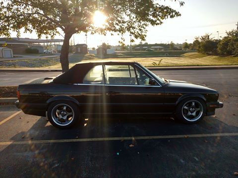

                    Ok center of wheel to the bottom of the fender is 12.75 inches. All my heavy stuff was moved from the trunk to the passenger seat (minus the spare).
                    The photos I attached previously the car was parked on an angled surface. When I measured the fender in the previous photo, I got 13 and 3/8ths, the other side was 12 1/2. So I think the car not being on level ground had a large factor in the way it looked, although I still think it needs to come down a bit. Maybe its just gonna be the spring pads coming out.

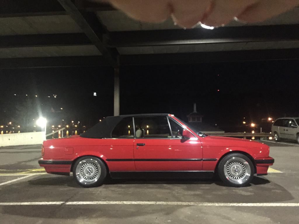

                                oem E30 M3 wheel conversion,,,
                                17 x 8" 215/40 9" 235/40
                                front KW + oem M-Tech springs,, rear,,, Bilstein B8 and H&R
                                car is very heavy,,,, 1450 kg or 3200 lbs
