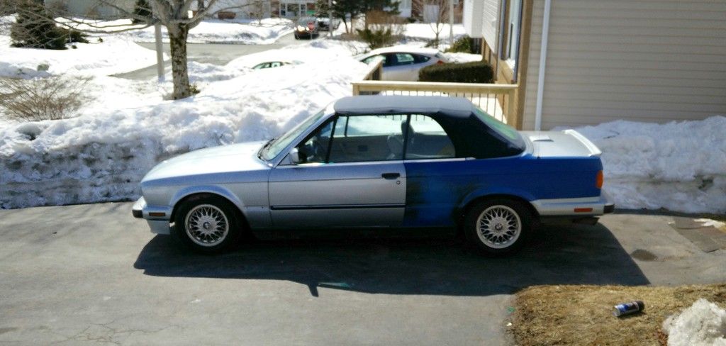

H&R Sport 50407 (cabrio-specific) spring set, with Bilstein Sport struts and e90 drop hats. Wheels are 17x75. with 215/45/17 tires. Offset is 18.
Rear has not settled but I may pull spring pads to even it out. I have never driven it on this setup so it may have room to settle. I also have the trunk gutted and no spare and no 'vert "counterweight" where the battery should be. Getting all of those things back in the car, plus installing my double 8" enclosure from German Audio Specialties should give me a more level stance.Comment
