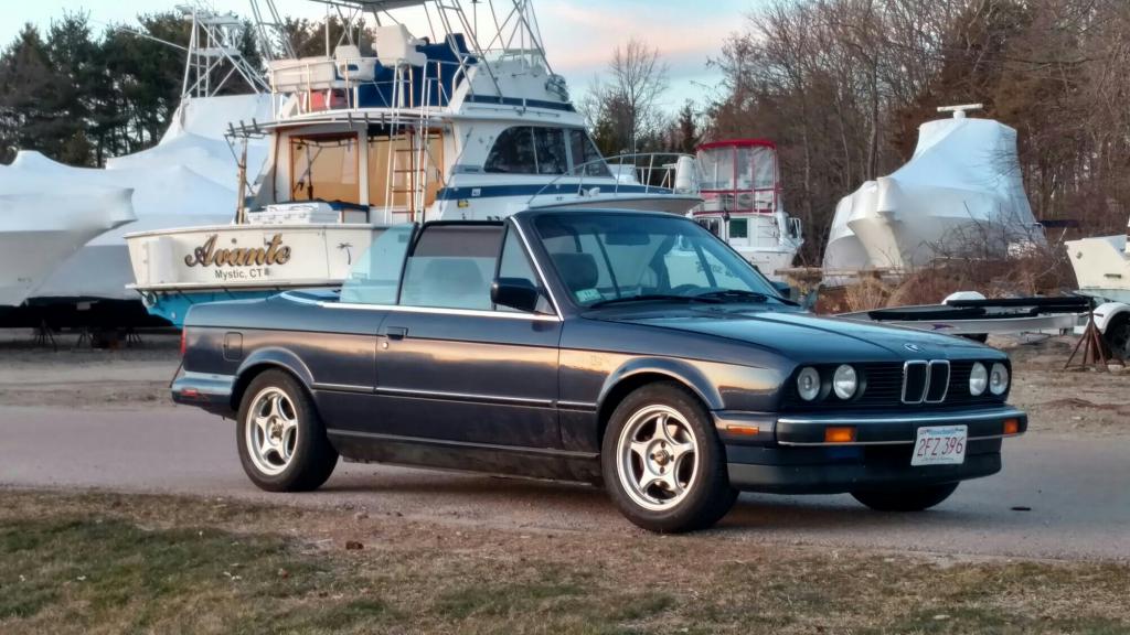

        Posting up as my previous photos weren't on level ground.
        H&R Race
        Bilstein Sport
        Full E30 M3 5lug
        16x7.5" E28 M5 wheels, 225/45R16 tires
        '89 Schwarz E30 M3 Cabriolet Build

            Originally posted by parkerbink
            looks great!
            Thanks, the ride height looks good to me but the ride is rougher than I'd like. I'm probably going to swap the springs out for Cabrio Sports.

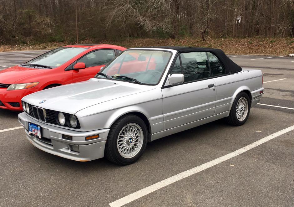

              HR Cabrio springs, Billstein Sports, Euroweaves with 205/55/15.
