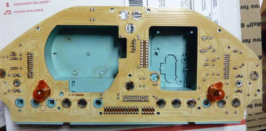

          Look, there are two orange bulb covers on the cluster circuit board.
          You can carefully take them out. Then, send them to me instead of throwing them in trash.
          You can also try to rotate the light knob to increase the brightness of the lights.
