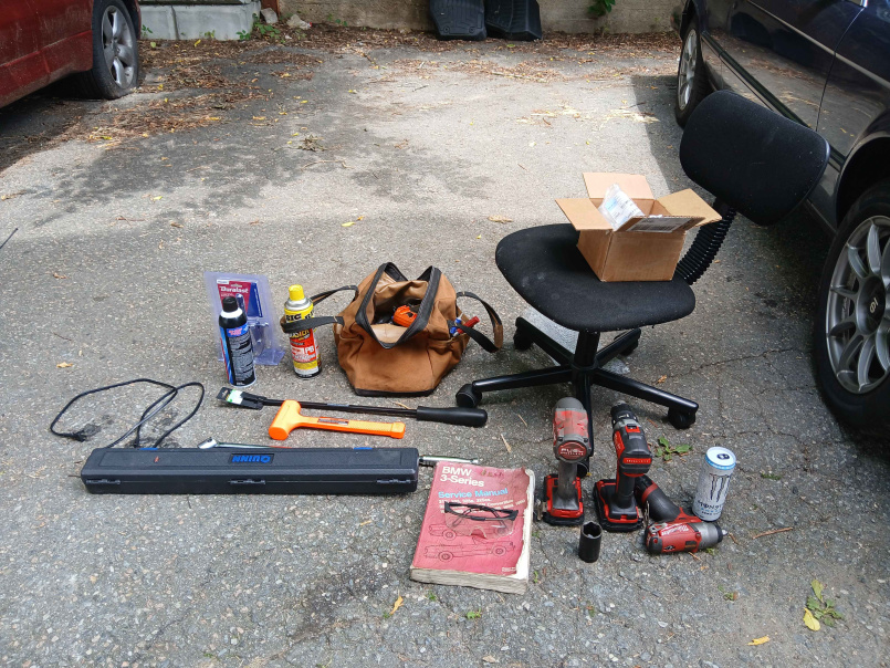

    Let's begin by going over the tools and parts you will need through out this installation!
    You will need:
    TOOLS:
    1/2 200 FT LBS Torque Wrench.
    Standard 2-3 Gear Puller
    Big Impact Gun that holds around 400-700 pounds of torque - (Removing 30mm Nut and installing.)
    30mm Socket
    Needle nose Pliers
    Brake Clean And Papertowels.
    Brass Punches/Chisels
    Dead Blow Hammer
    Flathead ScrewDriver.
    2X4 Block Of Wood
    VW Flywheel Holding Tool/BMW Flywheel Locking Tool - (Locking The Flywheel to install and torque the 30mm Nut)
    Large Pry Bar
    PB Blaster / Penetrating Oil
    Loctite - (30mm Bolt)
    PARTS:
    Clearance Motor Oil of your choice.
    Custom Homemade Trigger Wheel that you will weld onto your stock crank pulley OR Ireland Engineering M10 Trigger Wheel Kit. (NOTE: 02Again sells the bracket for your Ford VR Crank Sensor but they do not sell their trigger wheel kit as of 2019)
    BMW Front Crankshaft Main Seal: 11141709629
    BMW Crankshaft Woodruff Key: 07119951485
    New Shorter V Belt - Example: Napa 25-7330
    Energy Drink Or Coffee of your choice.
    Optional Tools and parts:
    13mm, 19mm, 17mm and 10mm Socket with small impact or 3/8 Ratching Wrench.
    Oil Pan Gasket
    Upper and Lower Timing Cover Gaskets.
    Red RTV Gasket Maker.
    Got Everything? Let's Get Started

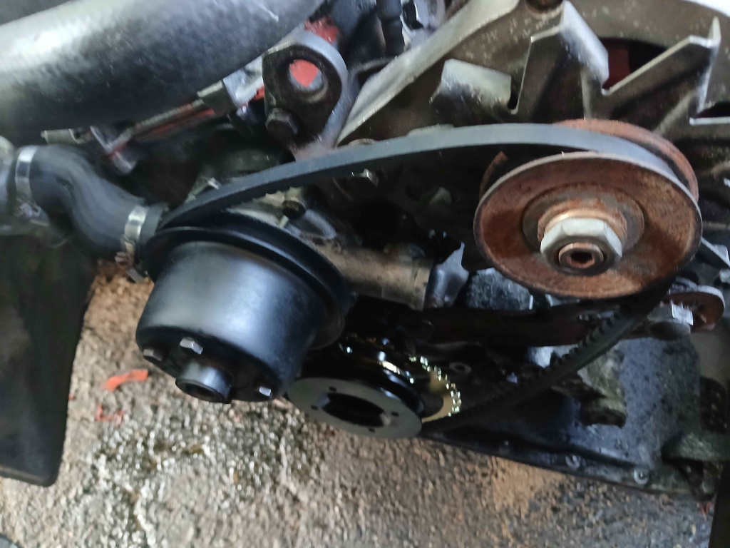

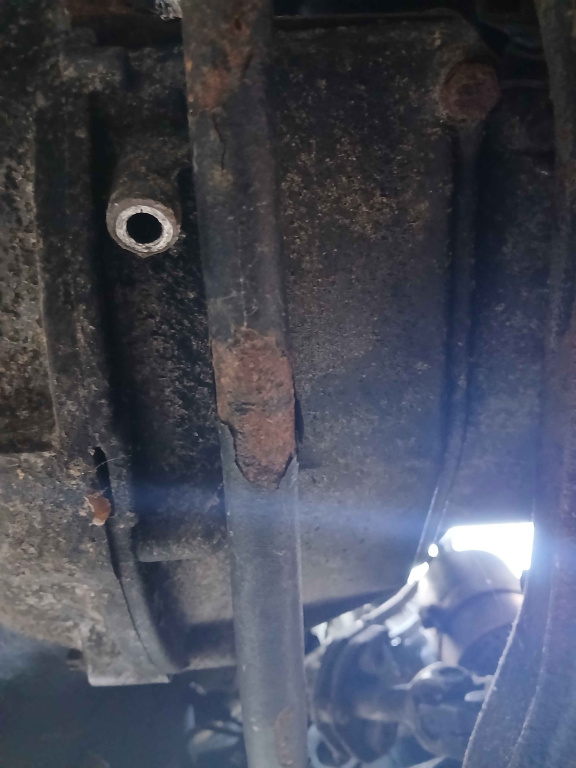

    Start by getting the car in a high gear and pulling up on the E-brake if you have a manual transmission, Make sure you get the engine properly in sync with the cam mark or timing mark itself on the lower timing cover, You will be able to get the crank bolt off with a 30mm socket on the impact but Ideally we will want to pull the inspection cover at the bottom of the engine where the transmission and engine meet up as shown in this picture:
    There are 4 13mm nuts, Two short ones and two long ones plus 4 E-Torx bolts that require removal before you pull off the cover. Next you will need to install the flywheel tool (Either the m10 unit or a VW Flywheel one) onto one of the available threaded holes that you took out the torx for, From research and personal shitshow under here, the bolt included for the VW tool might fit or not fit so whichever bolt you can slide into the flywheel tool and then screw it down so the flywheel is locked in place, THEN return yourself to the front of the motor where you will now lube up the nut with your penetrating oil, This shall help you as you remove the crank nut with your 30mm socket and impact gun, you can also use a breaker bar with a cheater pipe here if you don't have a impact gun at your disposal:

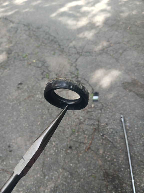

    After removing the pulley and then wiping everything down, You can do the following as to remove the seal: One: You can screw in a household screw and then wedge the main seal out with the screw in the seal. Two: You can lightly tap the seal inwards and then use a needlenose pliers to extract it. Either way you need to be careful since you can easily nick the cover and then you will have to replace it, Take your time here and ensure that you get it out before you move onto the key.
    (AS SHOWN HERE: THE NEEDLENOSE CAN PULL OUT THE SEAL WITH CAREFUL EXTRACTION)

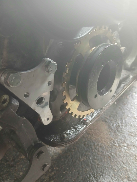

    To install the bracket, We're going to need to swap out the two 13mm bolts that are listed in the first part, you will also need to line up the sensor now since it will be painful to do with the bracket installed, Somewhere somehow it needs a 0-5mm gap so the sensor can accurately read the trigger wheel as it rotates itself.
    This is what it looks like without the sensor installed!

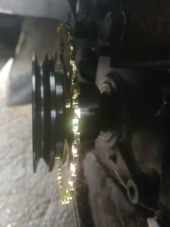

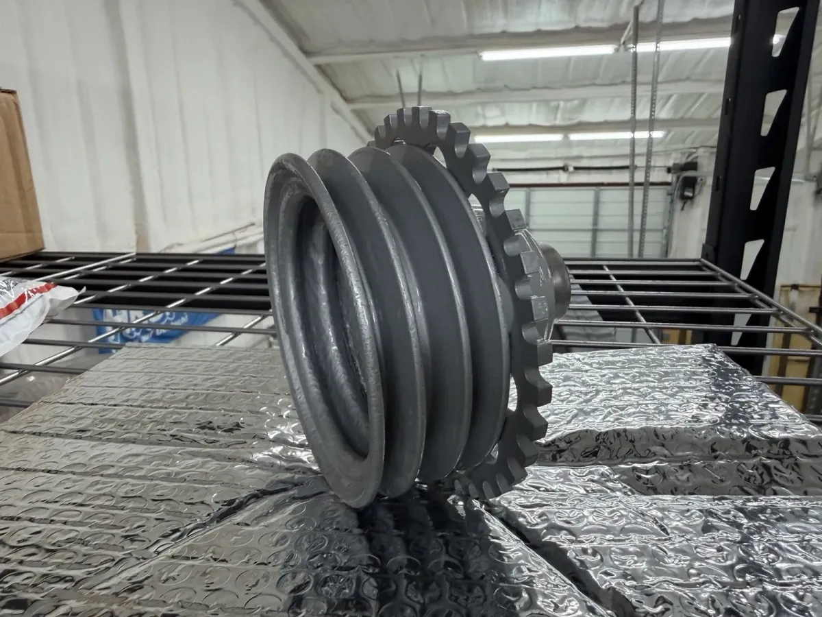

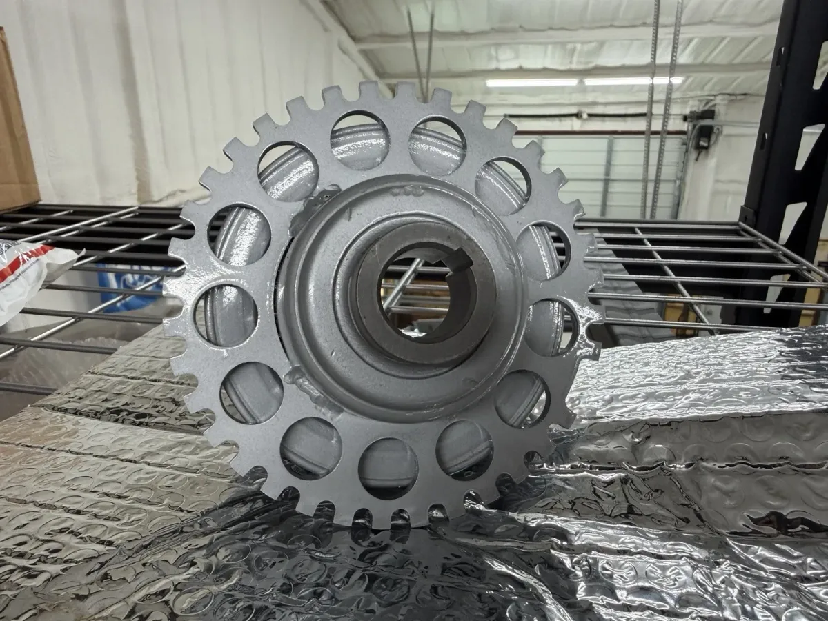

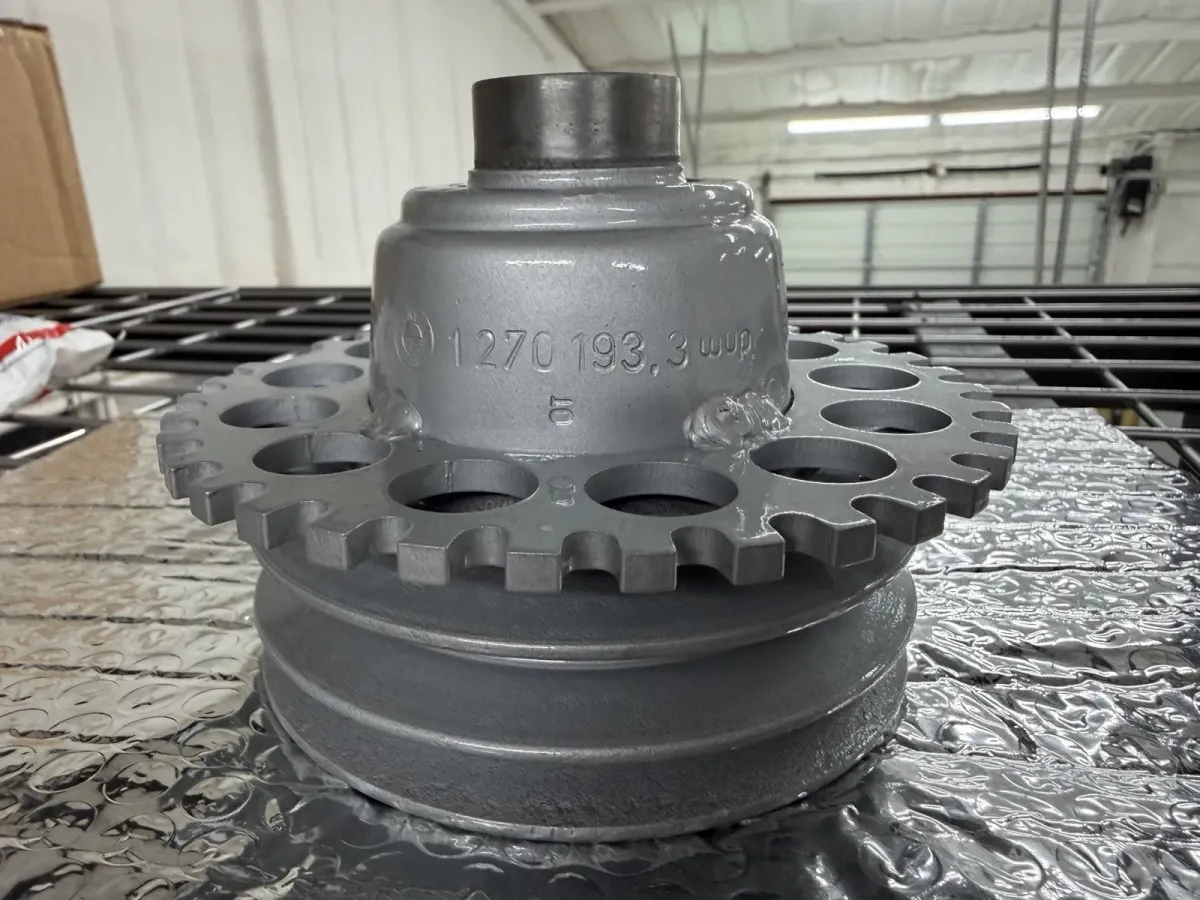

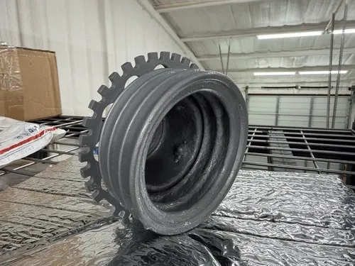

        As a final note for this tutorial, If you run into issues ordering a Trigger Wheel Kit from IE or they are out of stock for whatever reason, Sometimes you need to make your own crap so you can finish what you started.
        You can make your own homemade trigger wheel with a welding machine, patience and a good quality trigger wheel itself, The Process usually involves taking off your stock E30 Crank Pulley and then sourcing a trigger wheel that will work with the sensor that you'll use for this setup, VR Sensors only need two wires and a properly set up gap to read the teeth that pass the sensor until it counts the missing gap itself as one rotation, Hall Effect Sensors can also be used for this setup but they will not enjoy the heat and vibrations of the M10 engine, Typically the sensor is mounted with two water pump bolts so it's already near a hot thermostat and then it's exposed to all kinds of grime and vibrations. Hence The VR Sensor takes the win in this class. As for sourcing the trigger wheel, Take into account for how many teeth and the width and gap of said teeth since the sensor needs this info in order to work properly, A 60-2 Trigger Wheel is commonly used in stock vehicles including the M20B25/B27 in 325e/I cars, However you may run into clearance issues for mounting a 60-2 wheel onto the pulley and trying to fit it, This is why a 36-1 is used in all M10 Kits since it's small enough to clear the pulley and the area. As for material. If you buy your trigger wheel from a reputable source, it will be made with the correct metal that'll allow the sensor to read the trigger wheel, Alright... You got all of this? Good because There's a little bit of info on how to do it from e21 sources and 2002 forums but if you need an example of what you can make yourself:
ID:	10166145 Click image for larger version
ID:	10166147 Click image for larger version
ID:	10166148 Click image for larger version
        This is a stock E30 Pulley that has a 36-1 wheel attached to it. Feel free to download the pictures and examine it so you can get an idea for how to attach it! Cheers and thank you again Panici!
