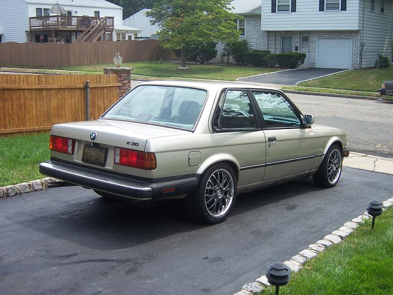

  • damith
    replied
    Shadowlining
    Here's mine. it makes hell of a difference
    :crazy:
    Leave a comment:
