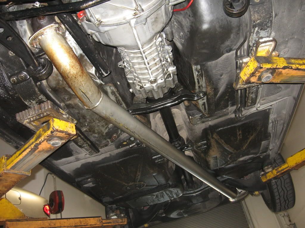

                    about 200 miles, it doesn't do much besides aesthetics and scraping everywhere. Obviously springs/shocks/bushings are what really change your ride. I like it though as a cheap 30 minute upgrade!
                    I only scape because of this:
                    And turning in to every parking lot/driveway in Houston, there's a HUGE ramp going up. It must be some strange zoning thing, because other than that, and the ridiculous speedbumps I see everywhere, Houston's roads are new and glassy smooth.
