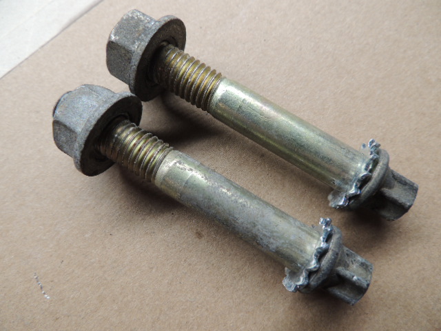

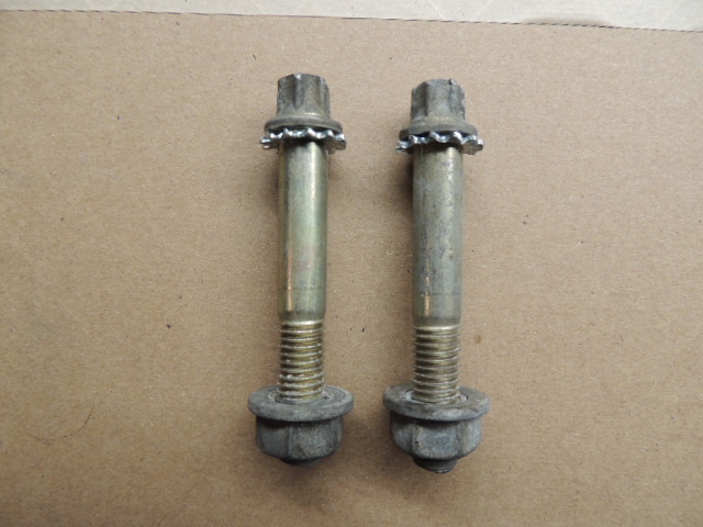

                                I know I could weld tabs on the bolt head end to stop them from spinning but, I had another idea... What about using star washers on them? My thinking is that the star washer will bite into the bell housing and bolt to provide enough friction so the bolt won't spin while the nut is tightened.
                                Thoughts?
                                I will report success or failure in a couple days when my new starter arrives.
