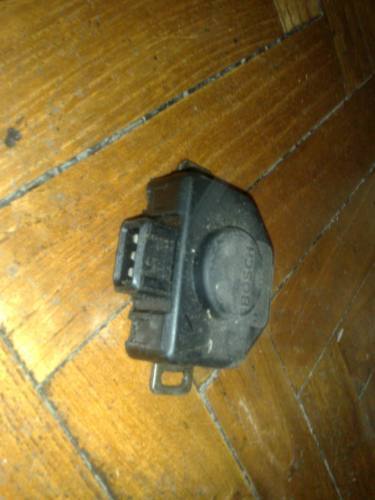

    Wait a minute, why does a hole need drilled?
      #32
      Older engine all have some blow by which settles in the intake manifold and runs down the throttle shaft into the TPS fouling the contacts. The hole lets it out before it causes issues. I've done all 3 of our M20's recently. 2 had oil in them and one had so much Im surprised it survived.
      You drill a 1/16 or 1/8 hole just above the "S" in Bosch which puts it at the center of the shaft or better yet remove the TPS, drill from the TB side, thoroughly clean, test & adjust it, throw in the new gaskets and a new TB to intake gasket.

        So you drill into the throttle switch itself?
          #34
          Correct..just a small drain hole in the center of the plastic cover which is the lowest part of the TPS when installed. Right above the "S" would put it dead center if you happen to drill from the outside. I did it from inside.

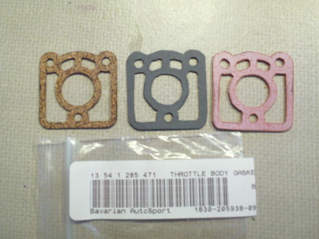

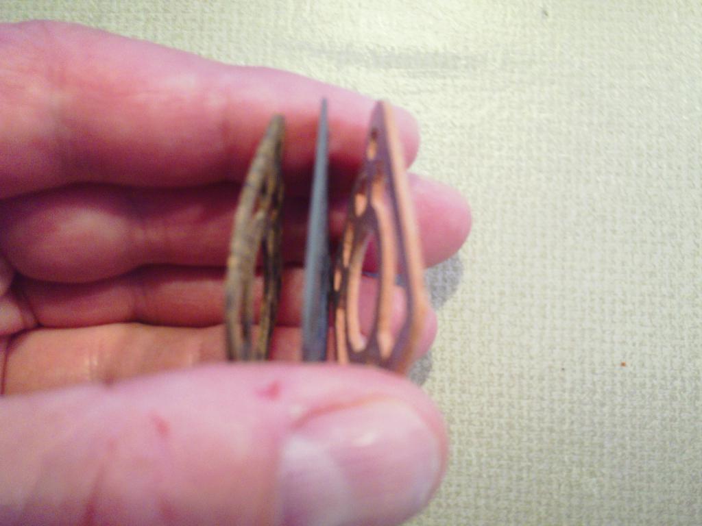

                            Make your own gasket
                            That cooling throttle body gasket has failed on me twice in a row right after T Belt Service - both times the water pump was replaced (and coolant too of course.) Those cork gaskets never last.......I guest the engineers look at that as a "cheap" failing point. I bought a new cork gasket (used it as a template) and made my own gaskets from two different gasket materials. I went with a (pink) rubber gasket mateirial. I used razor/exacto knife, scissors and a small file set. It was time consuming, about an hour or so. I did this because I tired of getting stranded with a coolant leak and an over heating engine. When my leaked it came out quickly. So far it has held 5 years. I need to change the T Belt. We will see what happens. I think using a better gasket material will make it last longer. The only down side I see is that that it is no longer a weak point and now a radiator or hose etc will fail instead but those parts fail too. see pictures....left -OEM Cork, middle and right are my "home made" gaskets. I went with the rubber material gasket (pink) on the right. It is almost twice as thick but it works.
