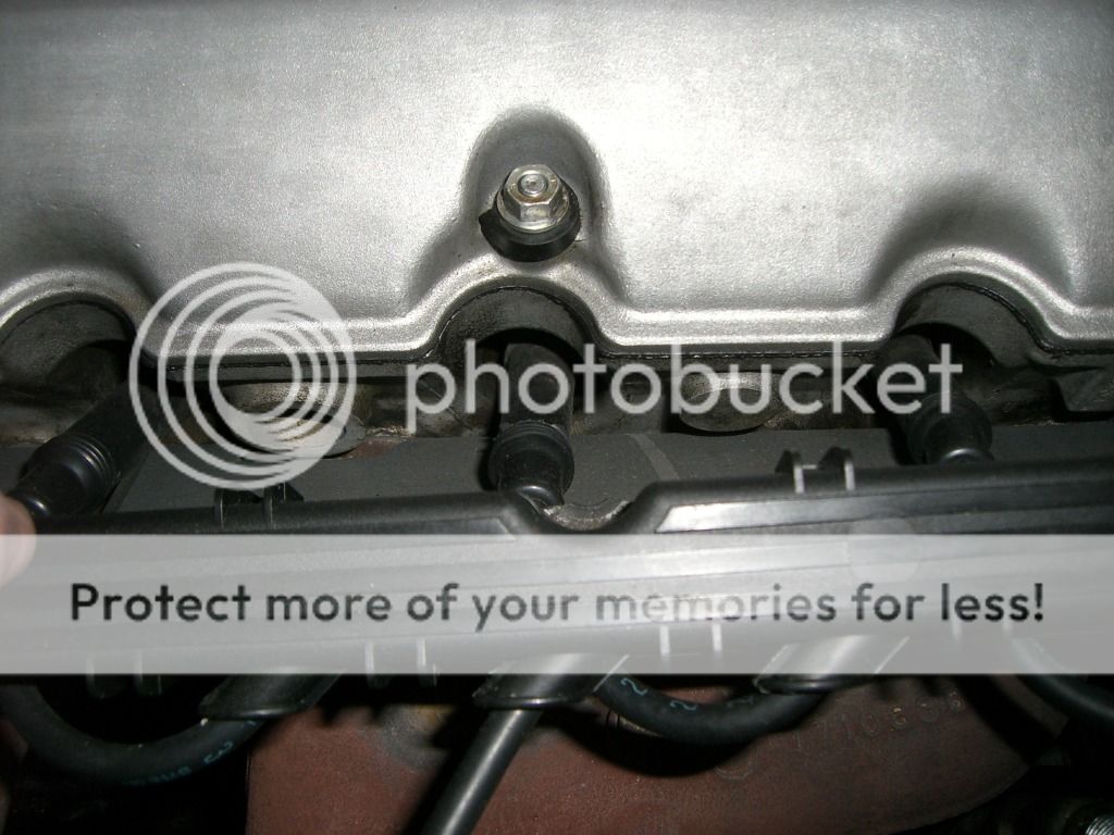

          I just checked my head I have the little round thing but not the 2.5 /2.7 does this mean I have the cruddy amc head here's a picture
              I'm not a head expert, but it almost looks like they grinded the badge off

              • Herr Faust Schinken
                • Feb 2012
                • 3580
                Thanks looks like I'm gonna haft to pull the manifold off to check
                  I don't think so, you can now see that I have added the info for an AMC head. You sir have an 885 head with that casting mark just machined or ground off. That casting circle does not exist on the AMC head at all above the #2 cylinder exhaust port.
