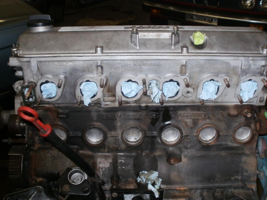

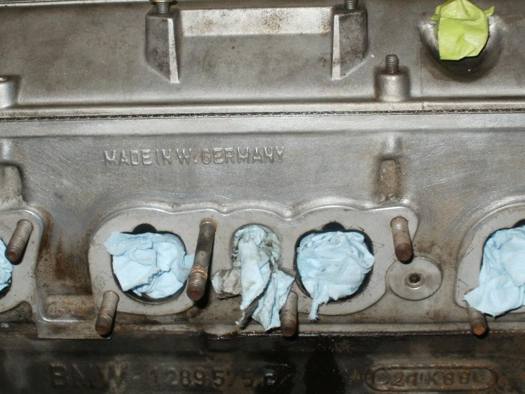

                            My 731 head i'm running.
                            • whodwho
                              • Jun 2008
                              • 1547
                              Those are not the intake ports of a 731 head unless it has been port matched to a 325i manifold

                              • meengreene30
                                • Mar 2012
                                • 369
                                Porting might have been done not sure. we were stumped with this motor too, came with a 272 cam, hd valvetrain. After a lot of searching we came up with it being a modified 731. Either way i'm really happy with this setup whatever it turns out to be, pulls a lil harder than my buddies 2.7i with same cam and valvetrain running headers.
