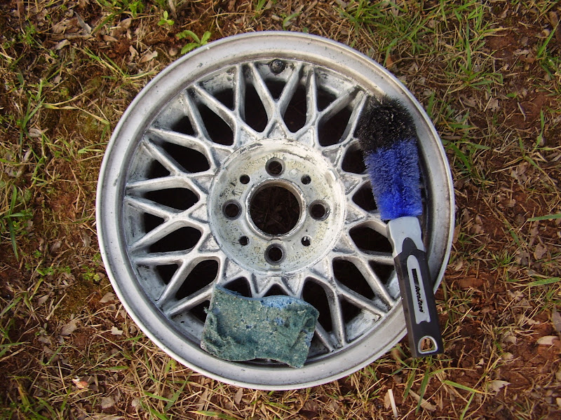

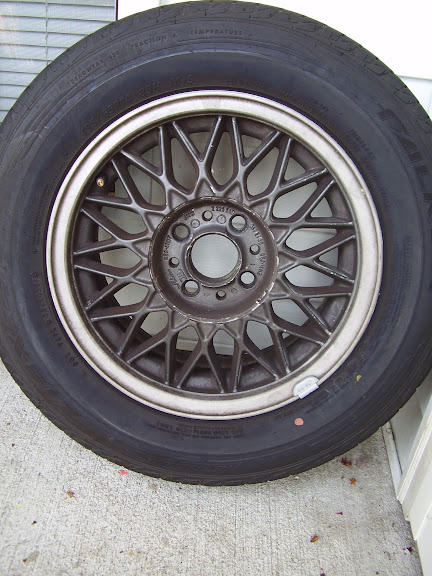

          thought I would bump this thread instead of starting a new once since I refinished my stock weaves.
          Started with this, an old dirty black weave...
          using some aircraft remover I started stripping the wheel,

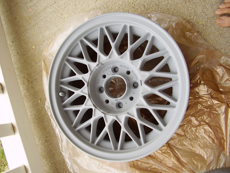

          I didn't get any pictures off the wheel completely stripped, but once I had all the old paint, primer, etc off I started applying the primer. I just used some duplicolor primer...

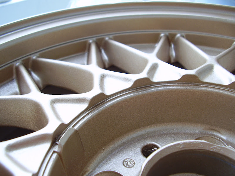

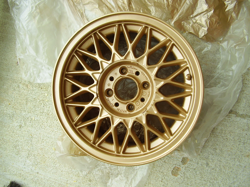

          I sanded with some very fine steel wool in-between coats. Once I was satisfied with the primer I started applying light coats of Duplicolor Bronze (I forget the exact name right now)...
          ...after about half a dozen coats (with sanding in-between) this is what I got...
          then I finished it off with about another half dozen coats of clear coat.
          I'll post pics of them mounted when I get all four done (I only have 2 done so far)
          Overall I'm pretty happy... some of the very tight spots near the lip didnt come out the greatest but whatever... they're just weaves :D I just hope they last....
