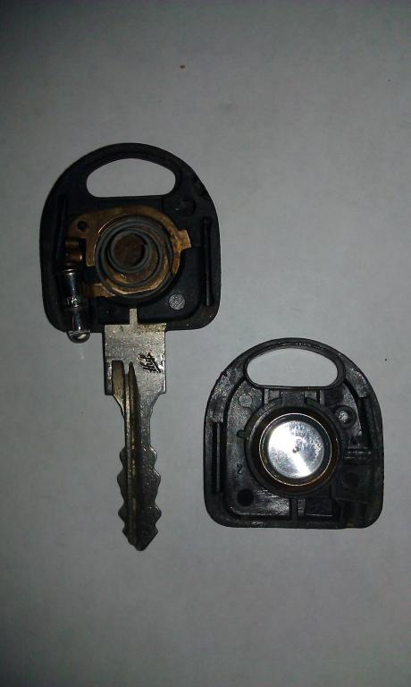

    here is what i got, i think its pretty much the same
    the middle doesnt slide out but the key separates into two pieces

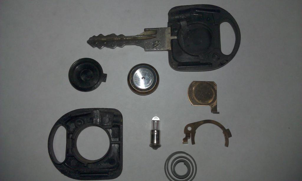

    here is a pic of everything inside
    hope you can help me out
    thanks again
    -mattscrog
    • JinormusJ
      • 6887
      The silver spring is negative, the copper filament is positive; the battery touches the copper filament with the positive base and rests on the spring with the negative base
      It's essentially the same as the key I modded; just follow the steps, but using your key instead, and you should be fine
