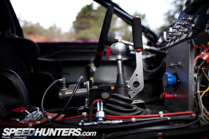

                      hmm now I want one of these set up for no good reason. Question, instead of using hard lines, why not use flexible lines like this one?
                      Originally posted by dvck
                      • burlmays9
                        • 227
                        #71
                        I would think cost savings would be the motivator to use hard lines.

                          #72
                          Use hard lines as much as possible. Even with steel braided flexible lines the handbrake felt mushy.
