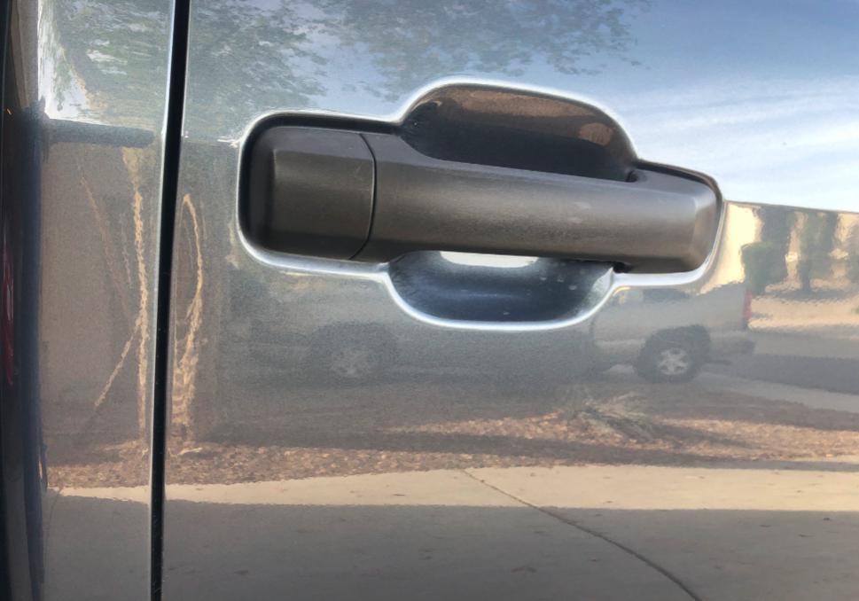

    Just did my 2010 Tundra. Looks great, thanks!

    I did it last night and I agree with the above poster. It took some trim that was so grey i was convinced that it would need to be painted and made it look black again
