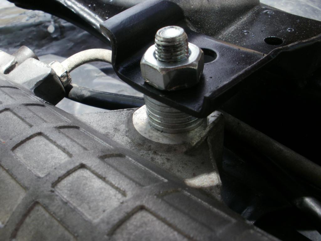

                            I'm in the process of doing the swap now with a 1990 325i Airbag car. I've shimmed the rack and bolted it in to the holes further away from the subframe because the rack boots came into contact with the engine mount tabs when I had it bolted closer to the subframe. Der affe said he didn't have to modify anything including his firewall plate and his setup was the closest to what I've got. Since I don't have to modify the knuckle I should be good to go right? Holy huge ass picture batman Sorry
                                Looks good but I'd put a washer underneath the head of the bolt and another underneath the nut too. Everything else sounds right.
