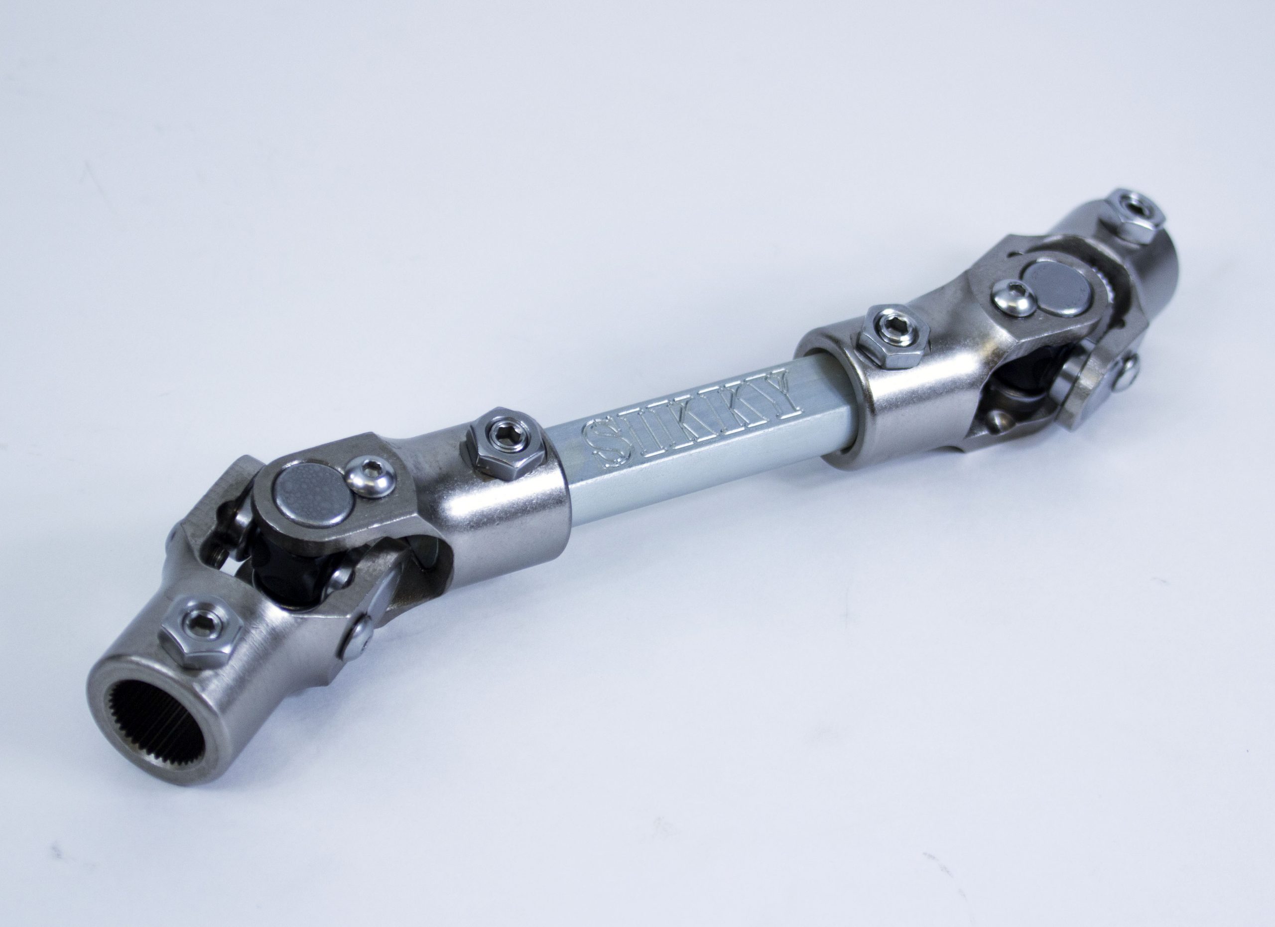

        I plan to do the E36 rack conversion for a pre facelift RHD.
        Is there anything unusual about doing this for RHD that I would need to know?
        Apart from spacers, and bending the power steering pipes?
        Sikky make a custom steering shaft for this conversion (LHD, LHD airbag, and RHD versions available).
        Sikky's BMW E30 Steering Shaft Assembly is a high quality, direct replacement steering shaft that will increase precision and provide sharper steering response.
