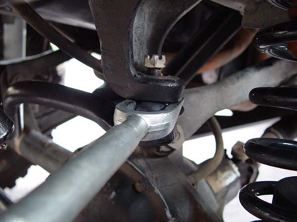

                                Originally posted by redhatpat
                                I've had good luck with this style ball joint puller and it was cheap, ~$15:
                                I think this style would work better, but I couldn't find one for a reasonable price locally:
                                Just did my tie rods with a tool like this. Broke loose in about 15 seconds. I got the tool at Harbor Feight for cheap.
