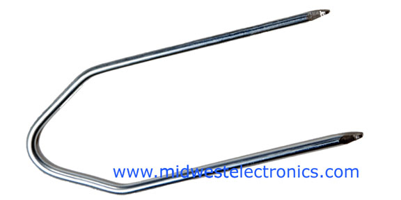

                      I did this after letting it sit at INSPECTION for months. Only got 3 green LEDs back, but the tool I used was a Blaupunkt radio removal tool. Ford radios used the same tool for a long time. Bend it in a little and it's perfect (for a late style connector anyway).
