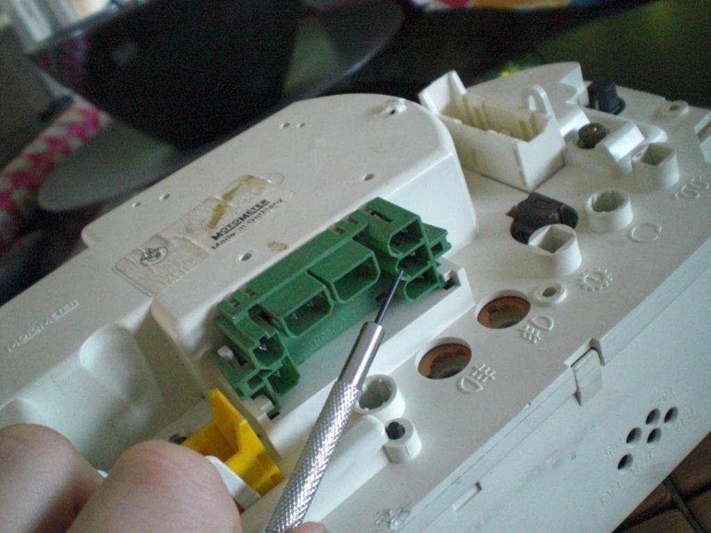

                              I cannot get my gauge apart. I took out all the screws shown in that picture including the two nuts. All I have left are the three screws show in the picture but it seems like the bottom of the cluster is stuck together.
                              1992 318ic
                                #90
                                You have to pull the green plug out, as shown below. There are also some clips on the bottom that you have to finagle.
                                Which brings me to my question, there's a wire in the car that plugs into the green plug, but there are three identical plugs for it to go in, and five that it could possibly fit in. I tried process of elimination but it didn't seem to do anything with any of them while the car was idling. Which one does it go in?
