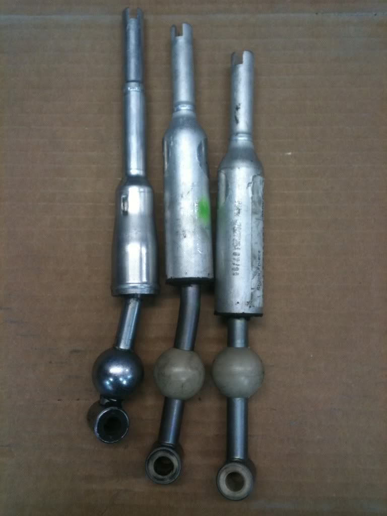

Another option you guys may want to consider is the e60 550i lever. It's bent like the stock e30 lever, and looks like it has reasonably short throws.
In the pic, you can see:
e30 -> e60 550i -> Mcoupe
The part number of the e60 lever is 25117546373
The part number of the Mcoupe lever is 25117527254
