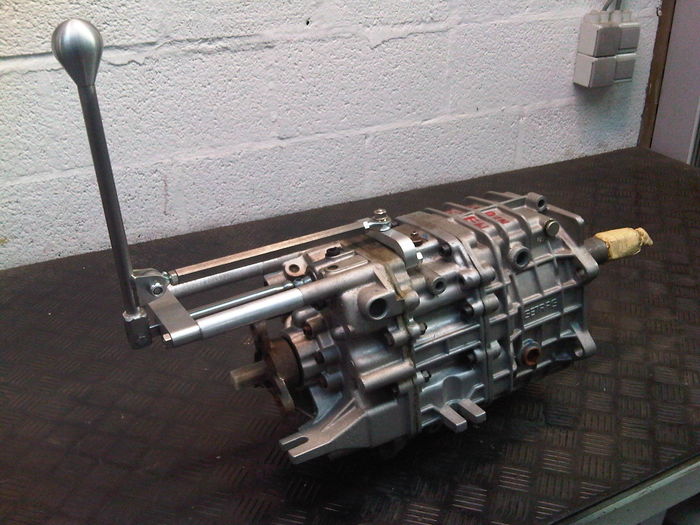

          Originally posted by dsphil
          I have been running my custom shifter and noticed that R and 5th gear engagement is not as smooth as I expected to be. The reason is, like all other short shifters, the extra length on the pivot point make going into R and 5th gear in a arkward angle as illustrated in my previous post.
          So, I have come up with this design. It can be fully adjustable because the spherical bearing can be set at any length in its pivot point. making it any throw desired.
          [ATTACH]112023[/ATTACH]

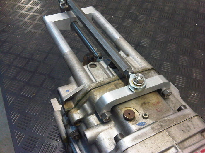

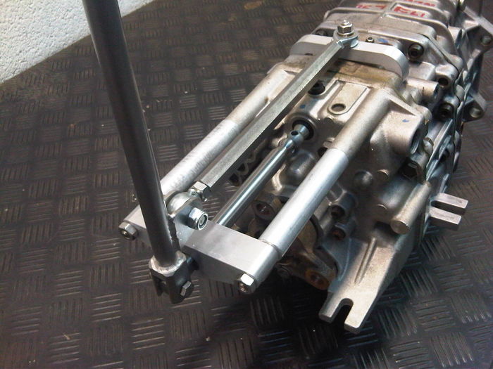

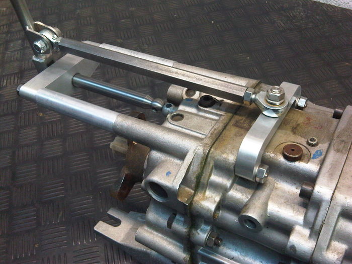

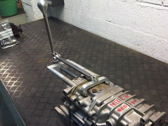

          I found an old auction for a similar design from Belgium, but the arm is mounted to the transmission, not the chassis:
          My transaction feedback on r3vlimited :):Clickety click
          • dude8383
            • Jan 2005
            • 10387
            #935
            That is a very clever setup!!

              • dsphil
                • 495
                #937
                That is exactly what I wanted to do, but dont have the resources like cnc or lathe. I bet it shift like butter.

                  #938
                  This design transmits all the engine vibration and noise through the shifter. It would be quite significant, especially with an M42. It would probably rattle a shift knob off pretty quickly.

                  • dude8383
                    • Jan 2005
                    • 10387
                    #939
                    On a racecar that doesn't matter so much... for the street it would probably get annoying.
                    • dsphil
                      • 495
                      #940
                      If the engine is health, it doesn't rattle at all. I am running a daily solid shifter with bronze bushings with no problems except for the extra effort in certain gears.

                      • Victell
                        • 1081
                        #941
                        My guess is that your solid shifter setup is still attached in the rear at the body, so its not a full transmission mount like this setup. The half body mount still provides some insulation.
                        The rattle I'm referring to is about vibration. The M20, like most straight 6 engines, are pretty smooth as their design is inherently balanced. 4cyls on the other hand have a harder time with it. The M42 has lots of vibration, especially because it doesnt use balance shafts to counter any of it. I still remember using e28 rubber motor mounts on in my 318is (OEM m42 mounts are liquid-filled and expensive). The vibration was ridiculous and I went back to OEM.
                        The rubber isolation that BMW and other manufacturers design into shifters is to insulate the cabin from these vibrations. Unfiltered M42 vibrations might actually make the shifter more difficult to use.
