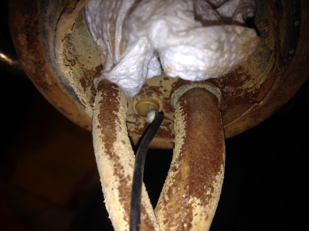

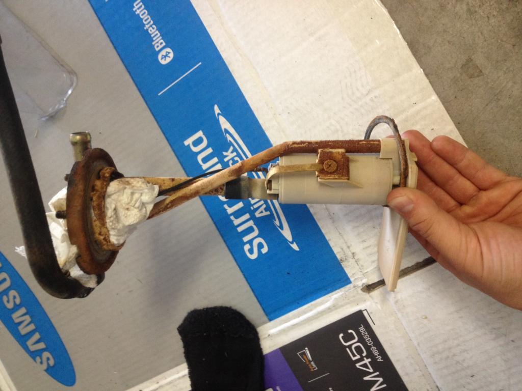

    I pulled mine out today to put in the walbro, but i wasnt expecting to have a late model pump and bracket (87 convertible) anyways, this is where im at right now

          Also, I am going to need to chop the metal piece that goes to the pump. My pump is too far down and actually hits the bottom of the fuel tank when i put it in.

            Lots of people mention this being easy, but this is turning out to be more of a pain than dropping the m50 in my e30... First of all the fuel pump that has a return line on it requires a lot more modification to get it to work, Did all that installed it. Ran great for about 30 seconds till i put a load on it. im not sure how to explain what happened. Now the car will not even start and it looks like my return line is clogged and was leaking into my engine bay. Due to the amount of modification to the initial bracket I can no longer even put the original pump back in.
            What a pain in the ass.
            • Blaine0002
              • 382
              #51
              The original feed line i had from the pump to the metal line burst, so i had to replace it with something a little sturdier.. In the end the car runs very nicely. I get no power loss that I had with my old fuel pump not sending enough fuel. Note that this is EASIER if you dont have a return line on your bracket!!!

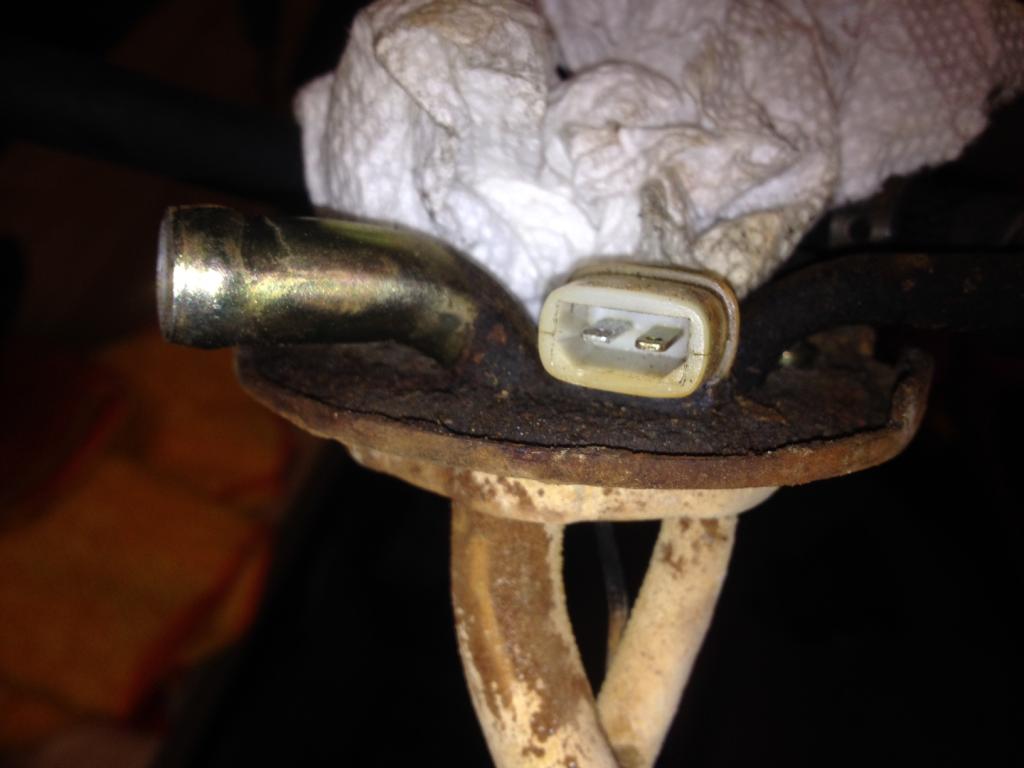

                      #55
                      My car is an early production 87 325i convertible. I am in the process of doing the single walbro upgrade but im not sure how to wire it up. My stock pump had 1 wire coming off from the plug. The ground is through the the metal piping with a metal (strap) going to the pump. How can i get 2 leads from the plug without causing a leak. Should i drill out the stock plug and epoxy a newer plug in? I just don't want to break the metal piping.

                      E30 Your Daily Money Pit

                        #56
                        Here's a pic
