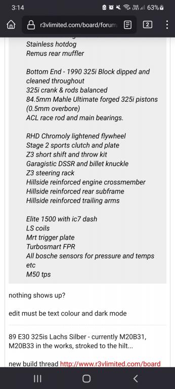

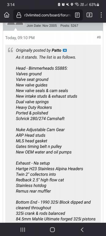

                nothing shows up?
                edit must be text colour and dark mode
