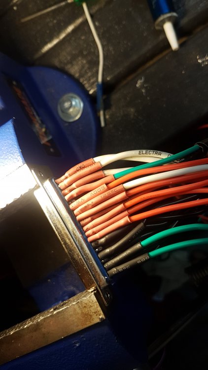

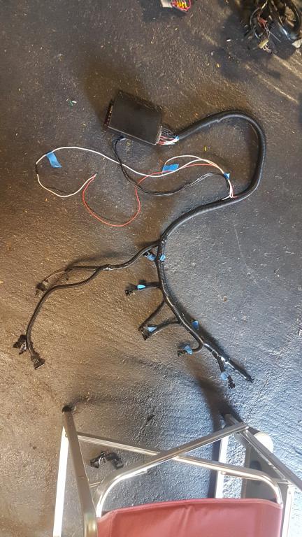

                It depends how hard core you want to go. I am converting my m20b23 L-jtetronic to Megasquirt. The L-Jetronic is the simpliest M20 fuel injection, very old school. not many wires at all.
                I tried to incorporate the oem harness, but eventually i just decided to bite the bullet and make a whole new harness, custom made. OEM was just missing too many wires.
                New bosch plugs, lume tube, db37 plug, a whole lot of soldering, self amalgamating tape etc.
                This allowed me to use any sensor i want anywhere, wire it in semesequential (2 groups of 3), proper TPS plugs, put all of the outputs into the loom. It should make for a neat install.
                These photos show it probably 75% done, I'm almost there.
                Oh and i used a 60-2 wheel and sennsor from an m20b25, bolt right on:)
