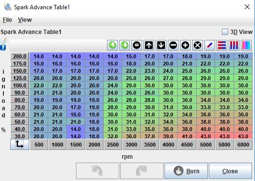

      Originally posted by SLEEPYDUB
      Here is my M20 E85 timing map.
      Setup is 885 head with a 280/274 cam and a 2.7ETA bottom end. Car runs very good and is very fast.
      Most importantly, my Tooth Angle #1 is set to 83 and falling edge. That is important to remember so don't just load these figures in unless you realize what that means!
      This is a lot of timing in boost, but it is a 2.7 bottom so the quench is not as good as an 885 head that would require less timing. So this may be way too aggressive for a normal M20B25!
      Would like some feedback on the map if anyone has any. I am still going to be making revisions to it once I hit the dyno.
      Sent from my SAMSUNG-SM-G935A using Tapatalk

                  #53
                  m20b25 turbo
ID:	7201067Click image for larger version
ID:	7201068this was generated on a dyno last year. stock m20b25 franken holset wh1c/ hx35? around 8psi. made 320/320. right before the head gasket let go lol 42# injectors. wastegate only
                  • SLEEPYDUB
                    • 658
                    #54
                    Why did the headgasket let go? Timing is pretty aggressive in that area for pump gas so that could be the culprit I assume?

                      #55
                      I would bet on the timing being too aggressive. ~21-22° at 140kpa is pushing the limit on a stock gasket and 93 pump fuel. Even in NA form, the engine doesn't need over 30.

                        #56
                        Yea that's what I was thinking. I run a lot of timing too but that's much higher then my map and I'm on e85 and a 2.7/885!
