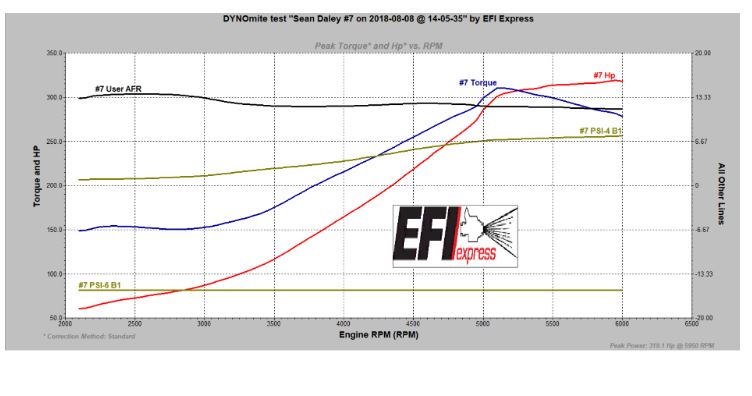

        Do you have a dyno graph of that run?

                          from what I have seen posted for other maps my ignition advance does not look a whole lot different from most of them. I am new at tuning 100%. could you educate me on what you are seeing with the tune im currently running? the car seems to run very well in most areas of it, the exception being cold starts (no icv) and cruising in 3rd gear with steady throttle.
                          • ForcedFirebird
                            • Feb 2007
                            • 8300
                            #73
                            Start with -2° off the stock tables for timing for 1psi of boost. I posted the stock tables earlier in the thread. Then add timing while listening for knock.

                              It's the tables you posted? I'm honestly surprised it runs well. Your fuel table looks very... Unpolished. What are you boost targets? 8psi? And boost cut at 21psi?
                              It is a little hard to tell the AFRs you are seeing on your dyno sheet, simply because the scale isn't great—wanna post a log?
