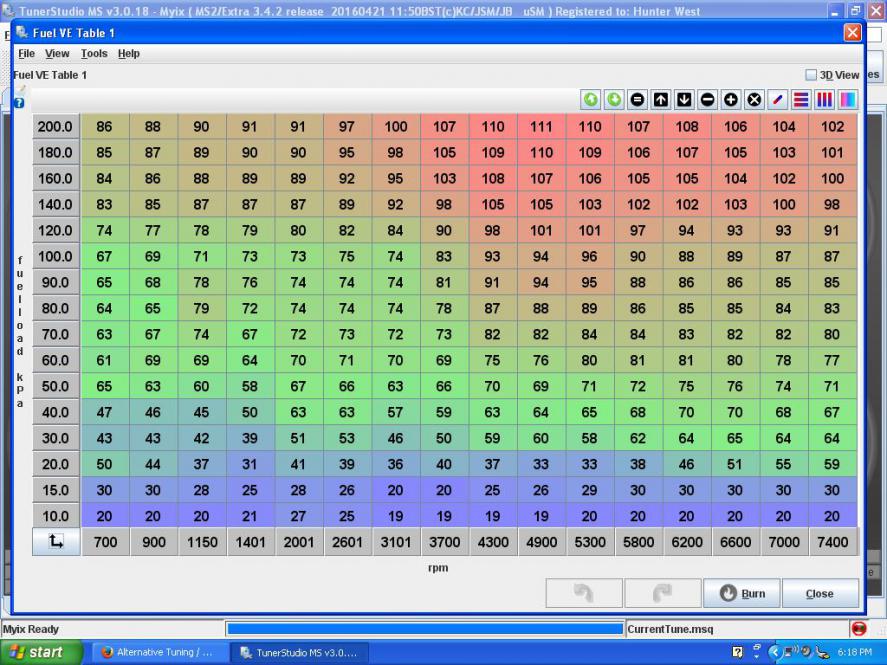

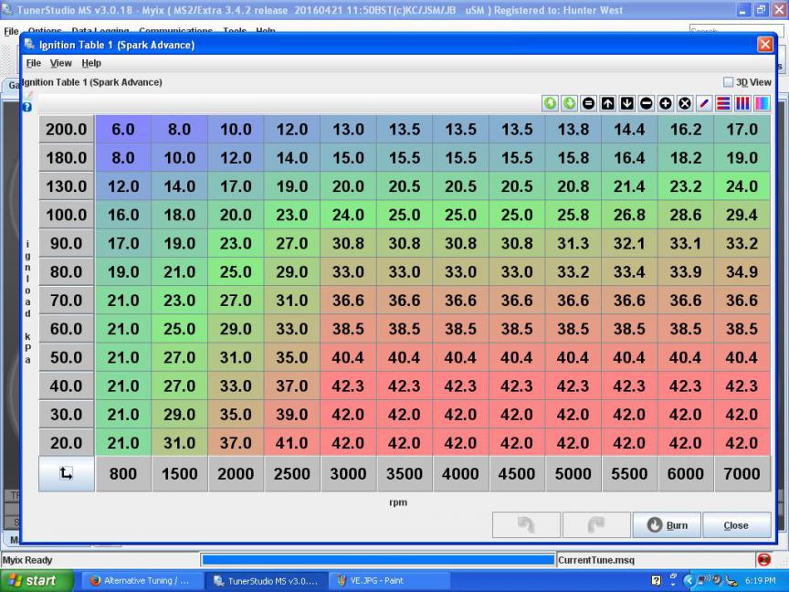

                    stock ix motor 885 head. ms2 n/a for now (stay tuned for twinscroll)
                    im pretty happy with how it runs. steve, or nomansland91 is helping me put together a quick spooling relatively low boost setup. power goal tentatively 250 whp.
                        I ran around with these numbers this morning (although I have greentop injectors) and I had to scale back every cell 15 points on the fuel table to run around at 12.9-13.0 at WOT. Just running your numbers as is gave me 10 at wot and cruise. Do you have an AFR gauge? What do you see?
                          Does anyone know how much of a difference going from 14.5lb to 17lb injectors make?
                          Well... If I'm not making any gross logical errors, there's a 17% increase in fuel flow, which would change the measured AFR by 17% under ideal circumstances, and on top of that, there are differences in other parts of the tune which could change how large this effect is based your particular fuel delivery equation variables such as REQ_fuel error, injector dead time error, MAT/Baro correction error, number of pulses per cycle...
                          All good reasons to be careful when using other people's tables, even if your engines are exactly the same you never know how your fueling equation differs due to errors made by you or the other guy during tuning. There are less variables with timing but it's equally dangerous because if guy A has a larger trigger offset angle than guy B and guy B uses guy A's ignition table, the result could be pretty bad for the engine.
                            that was with m50 injectors installed, i had it set for 17 pounders cause thats what i thought i had, and i was running 13.2:1 WOT, now running green giants. ill post the new ve table soon
                            • fergie
                              • Jun 2017
                              • 21
                              m20b25
                              ARP head studs
                              Holset H1C with 0.63AR turbine housing
                              38mm external gate recirculated w/ EBC at 12-13psi
                              3" turbo back to single magnaflow muffler
                              Wasted spark MSD Coils
                              36# injectors
                              94 octane no ethanol
                              afr under boost is 11.6-12.0
                              ignition table was setup on a mustang dyno and is considered conservative
                              • ForcedFirebird
                                • Feb 2007
                                • 8300
                                Not that it makes a bit of difference, but rather than posting the VE tables, shouldn't we be looking at target AFR's? I have found that unless a drive train moved from one car to another the VE always needs a fair bit of tweaking.
                                Hopefully people aren't copy/pasting VE numbers into their ECU's. On the other hand, I have found that similar combinations require similar spark tables - albeit a "2.7i" with flat pistons/885 is no where near the same as a true seta 2.7. The flat pistons want more advance (showing less efficiency).
