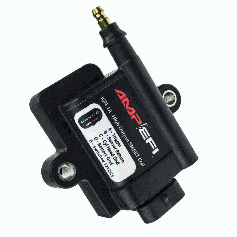

    When switching to coils. The "smart" ones. I lost signal to my tacho.
    Is there a setting or do I need to rewire it? Anyone have a clue?
    I used those wires as the signals. Normally l.e.ds go there.
    These are the coils.
    IGN1A Smart Coil by AMP EFI outputs 103 mJ of spark with 2.9 ms duration. Built-in ignitor, ideal for high-boost, coil-per-plug setups—no CDI needed.
