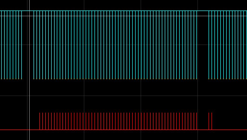

                              ^ Is your crank wheel set up for rising edge or falling edge? The tooth log should be looking like this:
                              RISING EDGE
