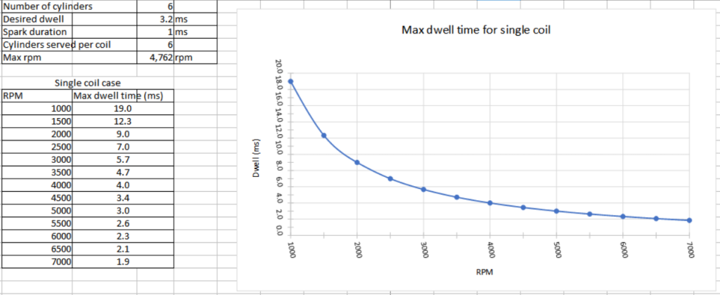

                    Did you run a tooth log while revving out and look for lost sync/pulse pattern? Just odd that it doesn't miss in neutral but will under load. I don't know if you have a single coil or not, but at 4,500rpm you only have 3.4ms of available dwell with a single coil. From a spreadsheet I made many years ago:

                      I'll check my dwell settings. I've looked at the tooth logs but I either miss the drop or it's not there. I'll post one.
