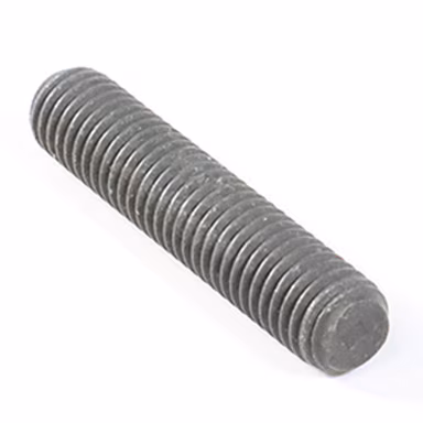

                    Anyways, one more question before I start ordering stuff... Looks like there might be two options for studs?
                    RealOEM lists:
                    https://www.fcpeuro.com/products/bmw...40-11621716870
                    BW has those and also lists these:
                    https://www.bimmerworld.com/Genuine-...4-E30-E34.html
                    15 bucks a piece kinda hurts, I'm hoping the second ones are good or if you guys have another P/N.​
                    • e30rik
                      • Mar 2014
                      • 84
                      Actually I misread the diagram, I guess the first ones are for the manifold to downpipe connection, but since I'm here I might as well ask if the second link is the best option for the manifold studs.
