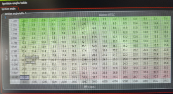

    Ive got an M20B27 ETA build and we measured it on HubDyno 307HP @ 14psi pump gas 95. I feel this is kinda low for this engine.
    I dont want to go on e85. My engine is fitted with a knock sensor and during the tune we used it. My tuner said that he senses knock so he do not wish to advance the timing any further. So we went along with the knock sensor data throughout the session.
    I know that knock sensor on M20 is quite unusual... I share my ignition angle table now and I would like someone with exprerience to have a look at it.
    My idea is that we might have gotten false data from the sensor that we followed and this prevented the car to make more power.
    Im hoping that someone can share their working tuned ignition angle table.

    Can you resize the table image. Its so small I can barely see the numbers.

          I'm running a MaxxECU Race with a knock sensor added directly to the block. It works flawlesly. When he slightly retarded the ignition timing, the knock immediately went away — which further confirms it wasn’t false knock. I fully trust my tuner. We weren’t able to advance the ignition any further because the sensor was already picking up signs of detonation.
          After several days of reviewing logs and going over every possibility, everything points to one culprit: my custom-made 3-pass radiator. The logs show water pressure surges in the cylinder head's coolant passages — reaching as high as 2.7 bar. The engine still uses the stock belt-driven water pump, which gives us no real control over flow rate. The coolant hoses go rock-hard under load, leading us to believe the 3-pass radiator is too restrictive. He also noticed irregular temperature readings on the coolant temp sensor during pulls — brief spikes and drops — suggesting possible air pockets in the system, even though it was bled before the dyno. It may be preventing hot coolant from escaping the head fast enough, which could be causing localized overheating and knock.
          According to my tuner, we're missing at least 4 degrees of ignition timing. If we could safely run that, the engine would make the power it's supposed to. Right now, cooling is the limiting factor. The plan is to revert to a single pass radiator and retest.

              interesting theory, though if correct you'd possible expect no knock until it becomes heat soaked? ie you'd get a few runs without knock and it should get worse with temperature. Can you see a trend like this?

                This happened during a single dyno session. In the warm-up phase we focused on fine-tuning the engine's under cold and warming conditions. Once the engine reached operating temperature, we shifted our attention to tuning for peak power. At the time we had no opportunity to investigate the issue under cold start conditions and we were initially unsure of the cause. It took us two days to identify a possible explanation and make a plan.
