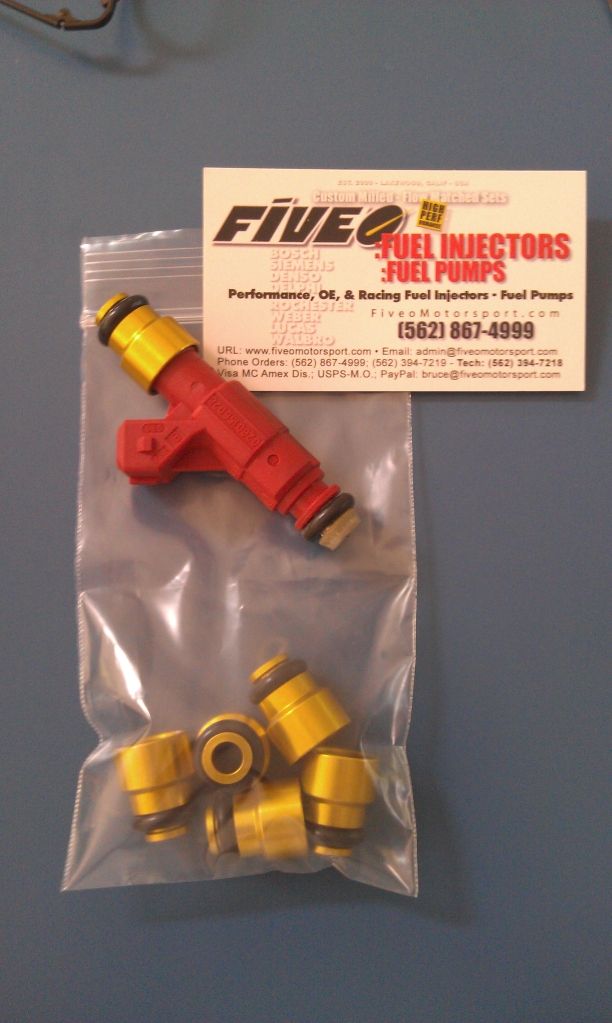

                          For you - I'd hit the junkyard. Me? I got them on ebay from a bimmerforums member, but they're five-0 motorsports injectors. Bruce hooked me up with spacers and I highly recommend them.

                          • nando
                            • 34839
                            where can you get spacers like that?
                            Build thread
                            Bimmerlabs
                            • Cyrix2k
                              • 593
                              I got them from five0. I think ID sells them too.
