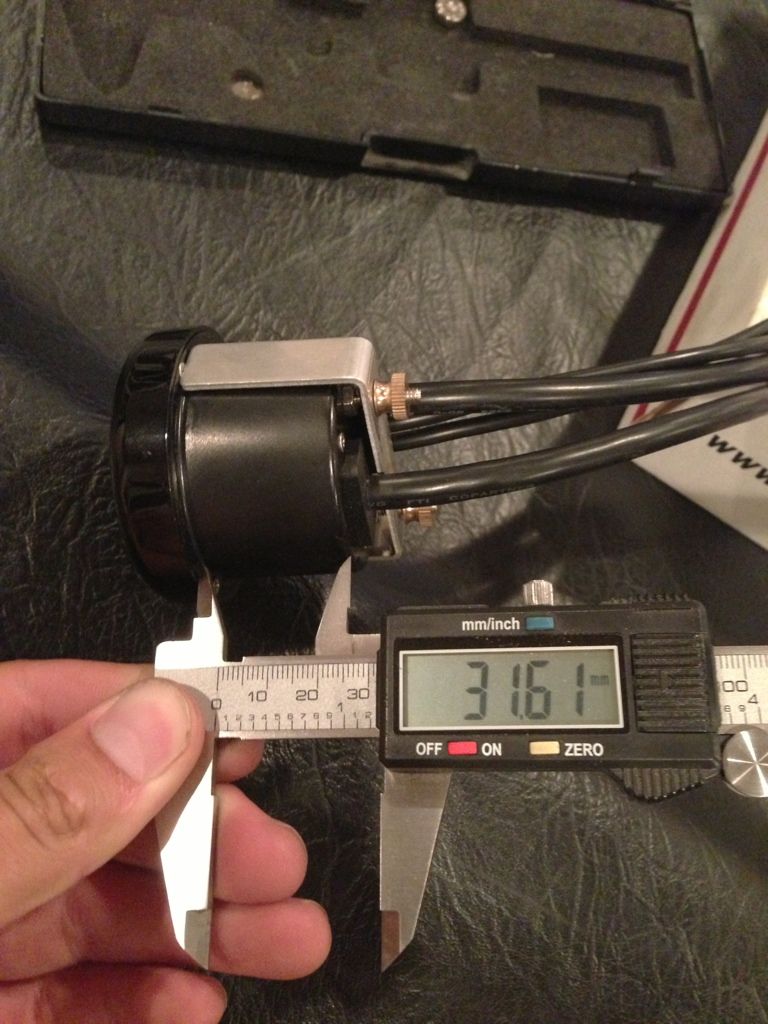

                      I can get some dimensions for you on the MTX. One sec.

                          You've gotta take into the account how far the wires stick out however...honestly I couldn't tell you that. It depends on how far you want to bend it.
                          The MTX fits in a 2 1/16" hole but you're right, the bezel is a big bigger
                          • bradnic
                            • Jul 2012
                            • 3554
                            GREAT pic jaywood THANKS!! definitely too big for the console both face wise and depth wise. So for aesthetic reasons - insert groan from the pure perf dudes - a remote AFR gauge and LC-1 is probably it here.
