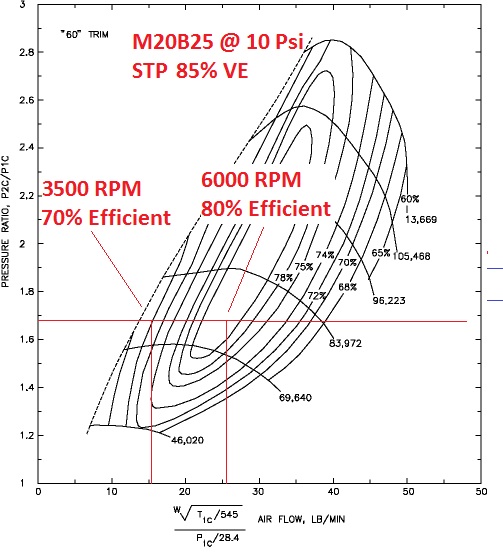

    I am trying to look at turbo compressor maps for turbo selection. The formula is straightforward for airflow of a piston engine.
    CFM = L x RPM x VE x Pr
    5660
    The problem I am having is trying to get realistic numbers from this formula for a boosted engine. Since forced induction can increase the volumetric efficiency of an engine the amount of air an engine can flow (CFM) should not only increase based on RPM, but also Volumetric Efficiency (VE). Displacement and Pressure Ratio stay the same. A soild value for 2 valves VE is 85%, and 90-95% for 4 valve heads.
    What I am missing is where the engine begins to increase over 100% volumetric efficiency.
    For Example an M20B25 at 10 PSI at Sea Level:
    PR = 14.7 psi + 10 psi/ 14.7 psi = 1.68
    (2.5 L x 2500 RPM x 85 VE x 1.68 )/5660 = 157.7 CFM
    Now at the RPM we want to be spooled by, say 3500 RPM
    (2.5 L x 3500 RPM x 85 VE x 1.68 )/5660 = 220.7 CFM
    And Now the same engine at 6000 RPM
    (2.5 L x 6000 RPM x 85 VE x 1.68 )/5660 = 378.5 CFM
    But shouldn't the engine begin building boost, say at 3500 RPM, and somewhere cross 100% VE and begin nearing 110% VE or higher?
    Let assume we get to 100% VE while building boost at 3500 RPM.
    (2.5 L x 3500 RPM x 100 VE x 1.68 )/5660 = 259.7 CFM
    And now the same engine at 6000 RPM assuming we are now at 110% VE.
    (2.5 L x 6000 RPM x 110 VE x 1.68 )/5660 = 489.8 CFM
    While spooling this is a 17.7% increase in flow and near redline this is 29.4% more flow. I belive this is an under approximation of the VE, but the point is the same, typical engine flow calculations should be higher due to the turbo's effect on the engines VE. Take a look at the map below at a 1.68 PR and the difference in flow on the compressor map. This turbo is either correct or may be too small for the m20, but with more accurate calculations shouldn't the effect of the turbo on the VE incorporated into the calculations make turbo selection more accurate? The PR is incorporated but it doesn't take into account how it affects the VE, just the AMOUNT of air in the engine, not the EFFICIENCY. I know im spewing, but what do you guys think?

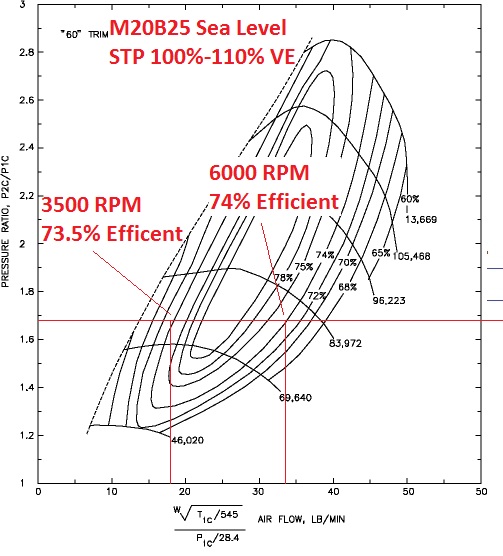

        The main reason I brought this up is for turbo selection. If you calculate a certain flow from the engine, but it is actually flowing more because an increase in VE has not been taken into account in the calculations, then the turbo you choose will be too small.
        Refer to the attached pictures, but I converted the CFM rating into lb/min numbers by dividing by 14.5.
        85% VE at 3500 and at 6000 RPM, PR= 1.68
        220.7 CFM = 15.2 lb/min
        378.5 CFM = 26.1 lb/min
        100% VE at 3500 and 110% VE at 6000 RPM, PR= 1.68
        259.7 CFM = 17.9 lb/min
        489.8 CFM = 33.8 lb/min
        Comparing the graphs below for the same exact turbo at the same exact pressure ratio; At the usually suggested 85% VE for 2 valve engines you can see not only does the engine flow less, but it is in a low efficiency at 3500 RPM, meaning the turbo is adding more than optimum heat. It is also just getting into the most efficient zone near redline around 6000 RPM. The second map shows the engine being more efficient at 3500 RPM and just starting to run out of steam at 6000 RPM. It is important to note the efficiency of the turbo is right in the powerband, about 4000-5500 RPM,
        Using a higher VE for the same engine at the same conditions produces the dilemma of what value to use. Because one formula shows the turbo being just right for the turbo, right in the rev range, pulling to redline and spooling quickly while the other shows some lag and being a bit big. Probably not much fun unless in the higher revs, like on a race track. So what VE are we at during FI and during spooling? You could see how this could make somebody believe their turbo will surge, when it really is incresing VE and not going to be a problem.

          hmm..
          so i just plugged in my numbers for a 2.0l m42. Also, i have 7mm valve, some porting, etc. Could i assume 95% VE? Im not seeing where your getting your VE value. Are we just assuming? Im having a hard time grasping this... :(
          PR = 14.7 psi + 9 psi/ 14.7 psi = 1.61
          2500 RPM
          (2.0 L x 2500 RPM x 90 VE x 1.61 )/5660 = 128.00 CFM = 8.8lb/min
          3500 RPM
          (2.0 L x 3500 RPM x 90 VE x 1.61 )/5660 = 179.20 CFM = 12.3lb/min
          6000 RPM
          (2.0 L x 6000 RPM x 90 VE x 1.61 )/5660 = 307.20 CFM = 21.1 lb/min
          So im almost positive im reading it wrong but in that first map it seems that it would hold well through the powerband? fuck... im going to try this again and ill be back to edit this post.

                Good point Digger, it seems I forgot one of the very basics of thermodynamics. The definition of Density vs Volume.
                But perhaps you can chime in on your thoughts on the subject of volumetric efficiency in turbocharged application if/when/as the VE increases.
                Actually I did some digging myself and found this website with the following equation, http://hpwizard.com/volumetric-efficiency.html
                VEboost=VEun-boost*((boost gauge pressure / atmospheric pressure) + 1)^(1/1.7)
                It is just as I suspected that boost raises VE multiplicatively (or in reality exponentially) with boost pressures. So what does this mean?
                For my example above of the m20b25:
                It would be accurate to assume VEboost at 2500 RPM is 85% because the we have selected a turbo already that will be big enough to not spool yet.
                From the last calculation, say 3500 RPM and we are boosting say we just spooled up to full pressure.
                (2.5 L x 3500 RPM x XY VE x 1.68 )/5660 = ??
                XY = 85 ((10psi/14.7) +1)^ 1/1.7 = 115.33 VE
                (2.5 L x 3500 RPM x 115.33 VE x 1.68 )/5660 = 299.53 CFM
                Remember my last post showed a guess of VE at 100% at 3500 RPM with a flow of 259.7 CFM. It was lower than what we will see if we are actually spooled by 3500 RPM. At this point, our flow will actually be 300 CFM when the initial formula showed 220 CFM at the same RPM. Using the initial formula (in the first post) we actually underestimated the flow by 36%!! Simply because we didn't factor in the VE changing.
                Lets see how we are up top of te rev range.
                (2.5 L x 6000 RPM x XY VE x 1.68 )/5660 = ??
                We already found the boosted VE: XY = 115.33 VE
                (2.5 L x 6000 RPM x 115.33 VE x 1.68 )/5660 = 513.5 CFM
                The inital formula showed a CFM of 378.5, and my guess of VE at 110 in the last post was pretty close to the 115 resulting in 489.8 cfm. Again, this is a 36% gain in flow from the original equation. So what does this mean?
                Lets plot it again with actual values for this m20b25 example at seal level and 10 psi.
                3500 rpm = 299.53 CFM = 20.69 lb/min
                6000 rpm = 513.5 CFM = 35.41 lb/min
                PR = 1.68
                This map looks great for the car, at full boost and 3500 RPM we are in the sweet spot of the turbo. We are far from surge and starting to run out of steam at higher RPM. This turbo would be great on the street, responsive
                and perfect for daily driving. It would not like the track much where hitting 6000 rpm continuously may happen, but would feel great on the highway. I also plotted the flow at 2500 RPM and 0 boost and it shows that line from 20% redline and PR = 0 is a pretty good estimate of how the turbo will spool.
