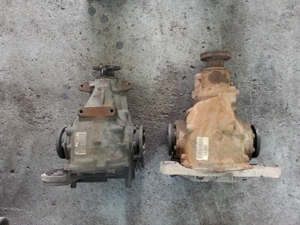

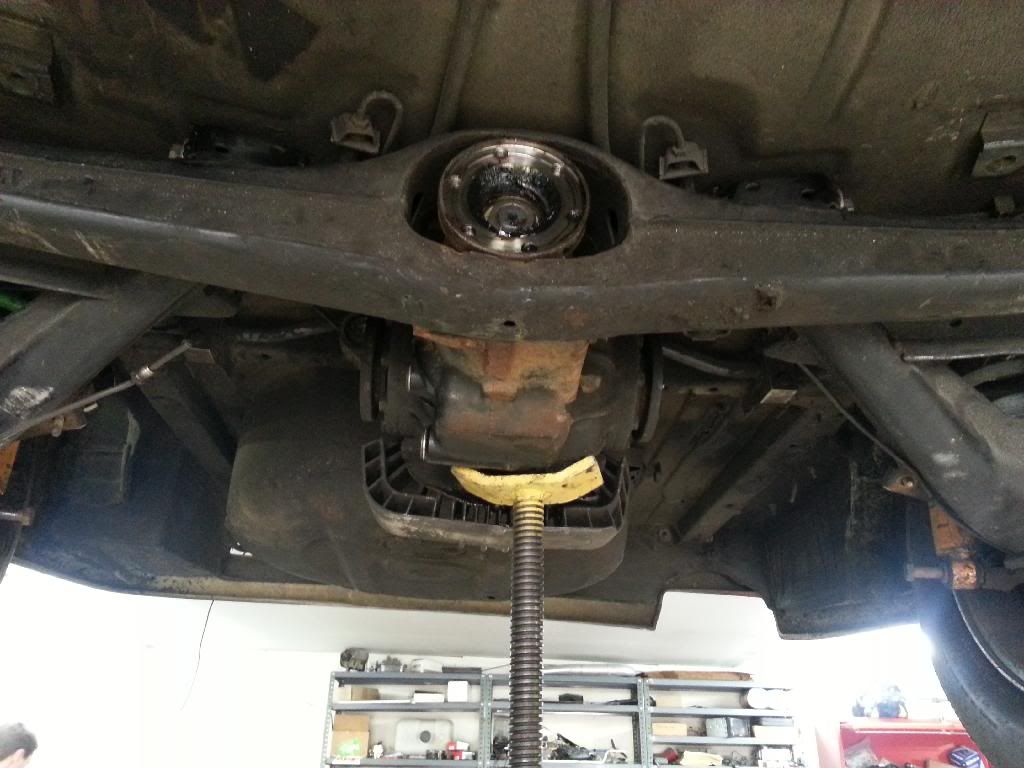

            Waiting on my new diff to come, I borrowed a mock up one for the time being to get it fabbed in so I can keep moving on getting a driveshaft made. Hopefully this works! e46 m3 210mm diff
            Other than that its a waiting game. Need to measure up and order driveshaft once this is solid. Then hopefully input shaft will be on its way as well as hydraulic release bearing and adapter.

                            diff for sale! along with driveshaft...
                            MaximumPSI.com
                              #74

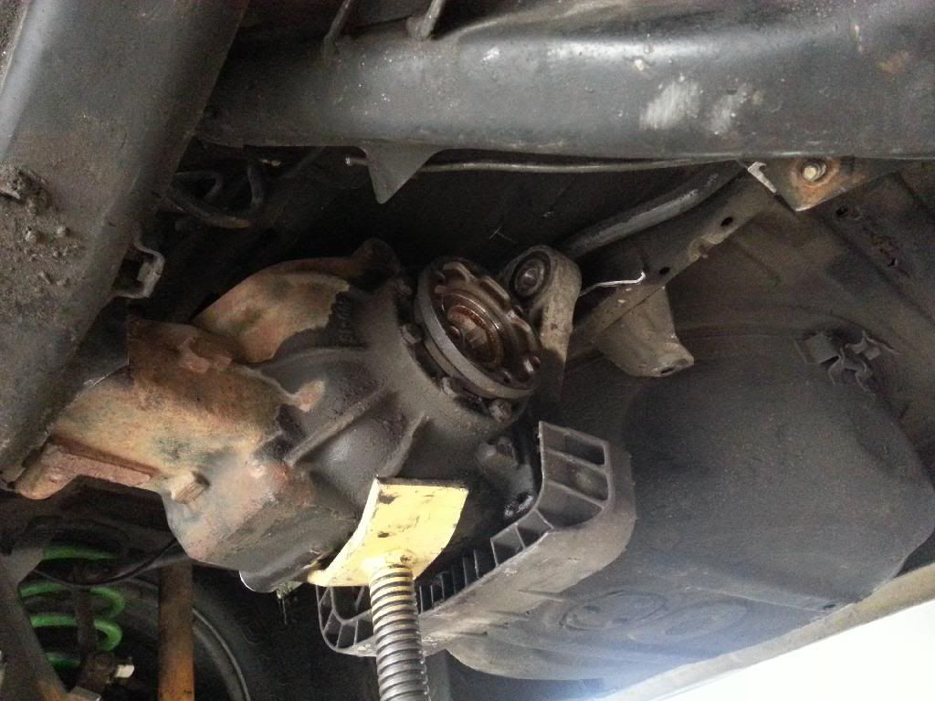

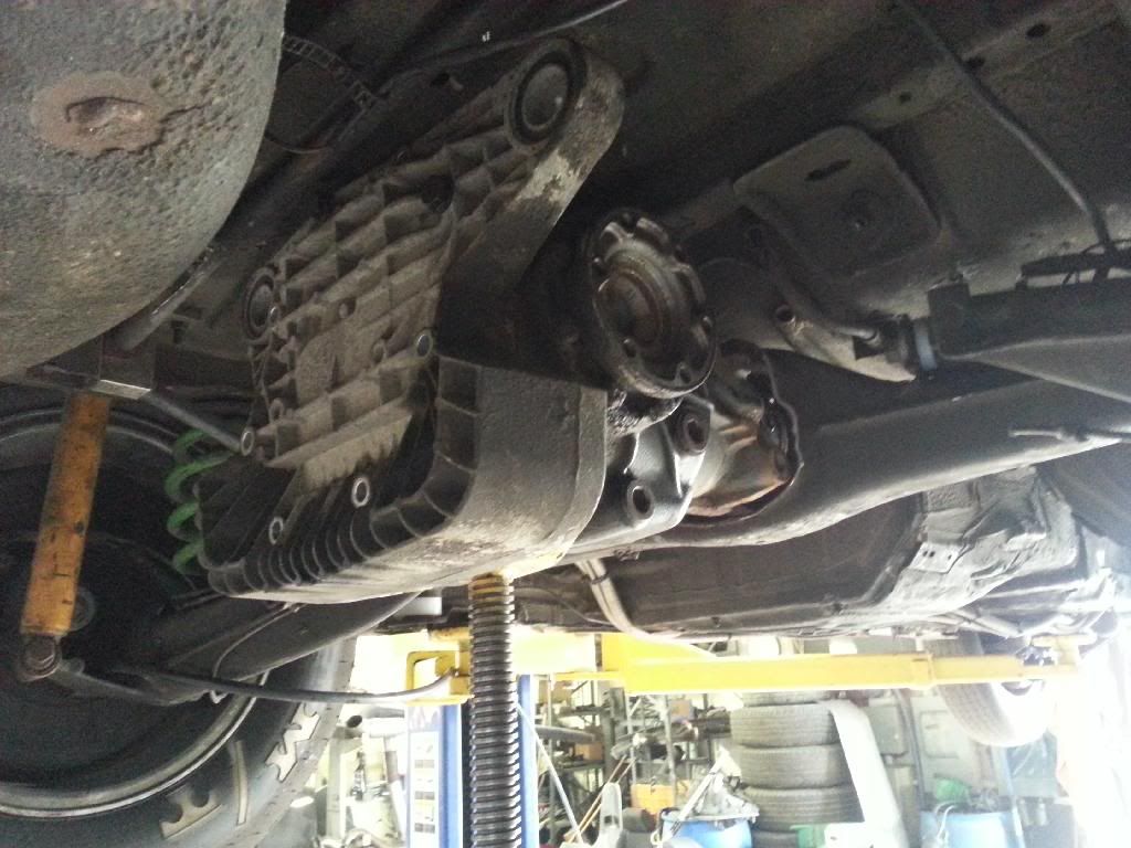

                              The e46 diff is almost a direct swap, just need to rebuild subframe, make gussets and weld it out.
                              MaximumPSI.com
