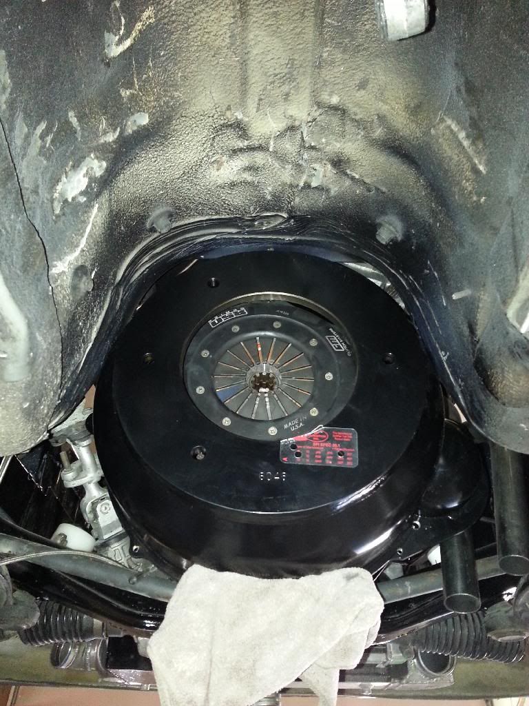

          They Chevy bellhousing fits, it will take some massaging of the tunnel but I think it won't be too bad. Just have to get another bellhousing because this one has poor sfi sticker placement...
            http://i990.photobucket.com/albums/a...psfijbtrl3.jpg
            What do you mean by "Chevy" bellhousing?

              #51
              No one makes a Lenco bellhousing for a BMW. So I'm using a Chevy one with an adapter plate.

                  #53
                  Ok.
                  I've run across a few companies that make custom bellhousings. I think Vorshlag had one made for their GRM $2010 challenge E30.

                    #54
                    Originally posted by The Dark Side of Will
                    Ok.
                    I've run across a few companies that make custom bellhousings. I think Vog had one made for their GRM $2010 challenge E30.
                    Yea that's not an issue there are a few companies that can build one. I need it to be a sfi certified and if thats possible im sure it would take a long time and be pretty eexpensive.

                      #55
                      I'd have to go back and look at their source, but it was several hundred dollars... It was SFI cert, though. The company does it for a living, so I don't expect lead time would be unreasonable.
                      Do you already have the adapter plate?

                        #56
                        The one I just returned was $600. Adapter isnt made yet. Any idea on company name?

                          #57
                          <dig dig dig...>
                          Quicktime/Lakewood. Their website isn't so great, so you'll probably have to call.
                          Vorshlag used a Chevy LS1 to Ford Toploader housing. I just saw Mazda Rotary to Jerico and other wacky combinations.

                            #58
                            That's the bellhousing in the picture... hopefully getting another of the same with a good sticker
